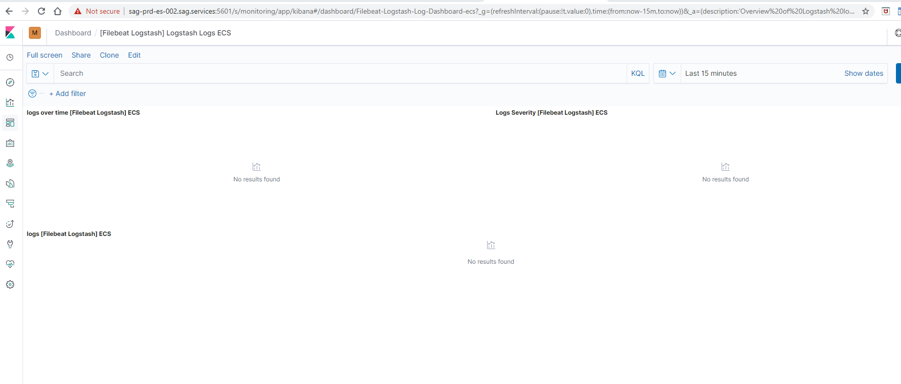

Even though i receive filebeat logs they are not parsed by loglevel as the image shows below:
And finally why i see only empty filebeat dashboards ???

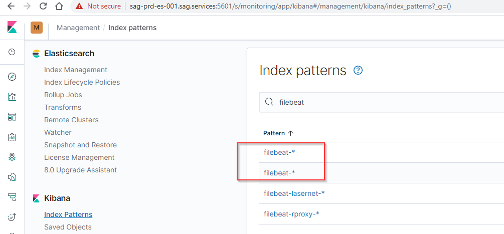

  • At the past we had installed filebeat in a host outside of the elastic cluster in order to monitor him, thats probably why you see the LogLevel field in Kibana.
The weird thing is that i see 2 times the filebeat index:
and i have 2 index patterns:
Also the number of fields in these 2 index patterns have different number of fields:
What shall i do to correct that issue?

I configured the paths that way because as the image show below i have these types of logs in the path: /var/log/logstash
Neverthless, i stopped receiving logs since i did your recommended changes as the image show below:
So what am i doing wrong again? :slight_smile:

The two index patterns can be caused by creating one manually, and another one with filebeat setup. Internally they will have different identifiers. You can probably remove the one with the mapping conflict. Another option is to remove both of them, and run filebeat setup again. In any case this shouldn't be a problem for data ingestion, these index patterns are only used by Kibana.

Hello Jaime,
the filebeat log files are he following:
Nevertheless they dont contain some kind of info about the paths
When i see the filebeat status i dont see any errors but still i dont get any logs in kibana from the specific server
In addition i stopped filebeat and run it again with the command: filebeat -e
The results are the following:
So i have the error: ERROR instance/beat.go:933 Exiting: Error while initializing input: No paths were defined for input accessing 'filebeat.inputs.0' (source:'/etc/filebeat/filebeat.yml')
Exactly after that (and without changing anything in my filebeat configuration) i restarted filebeat and check again its status as the image show below and it is in status enabled:
Nevertheless still no logs received in kibana.... What else shall i try?
If i dont filter in kibana by that specific index name i get logs but that is because i receive the filebeat logs from the servers that we had installed filebeat at the past which are not in our elastic cluster...
This fails because you have an input configuration without paths. Could you please remove or comment out the input you have in the filebeat.yml file?

Hello Jaime,
Even when i disable multiline control and i have just a one line log entry
Parsing from filebeat fails:
Is it possible that the gork parse failure occurs because of a bug in the filebeat version?
Or am i doing something wrong again in the configuration files? :slight_smile:

Hello Jaime,
Some are supposed to be parsed correctly and as you see in the following pic they dont have the grok failure message. Nevertheless, the message field is not parsed correctly i believe because it doesnt even contain the date in the beggining as all logs do:

Finally, another weird thing for me is that when i expand a certain log entry i dont see nowhere the log.level field. not even in the right pane
but in the index pattern it exists:

Regarding the lack of the log.level field in this Kibana view, this field is only going to appear on events that are correctly parsed, I see in your screenshot that the event is one that couldn't be parsed. Could you check with an event that is correctly parsed?
