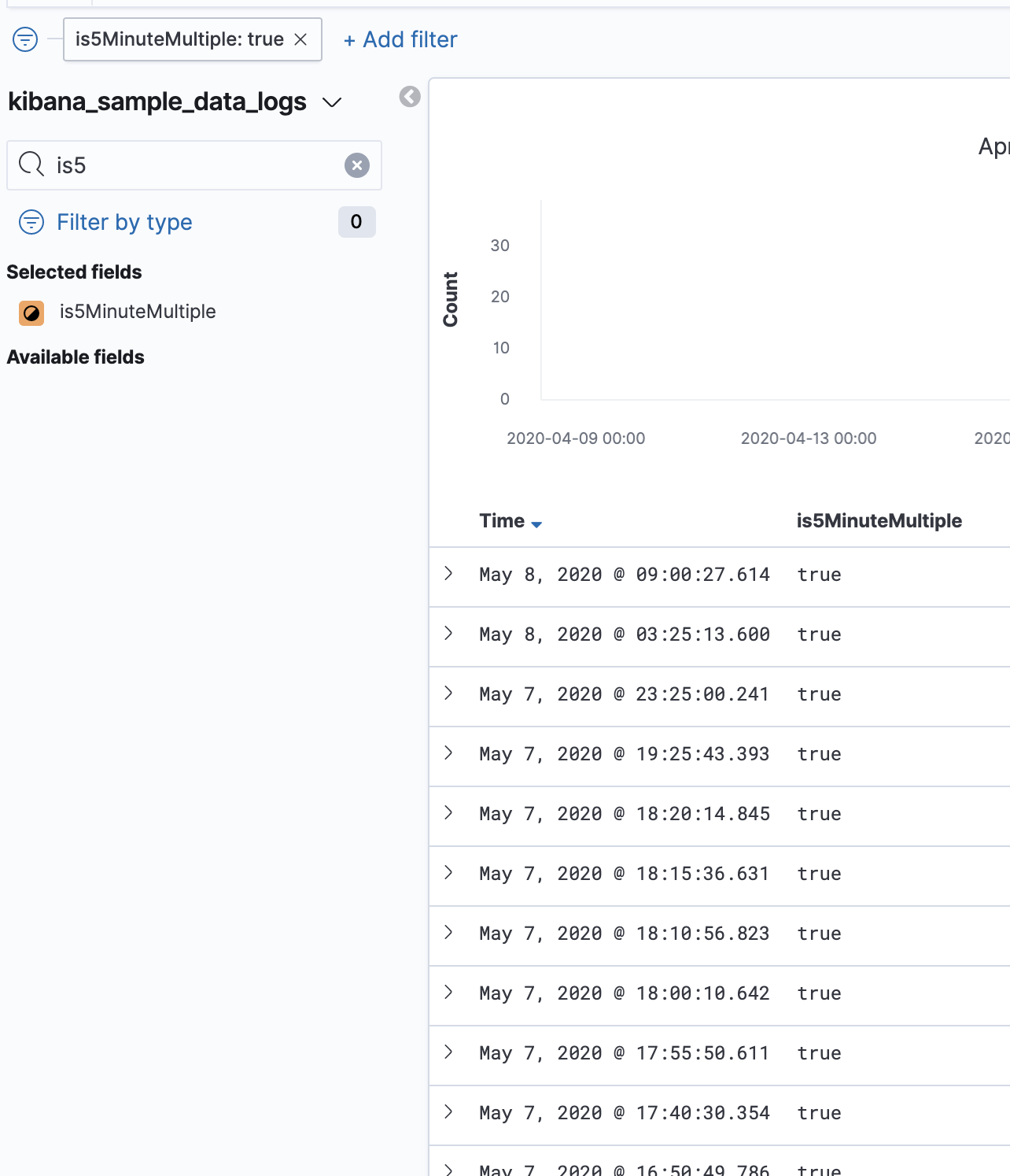

I recommend the following - create a scripted field of type boolean called is5MinuteMultiple with the following script:
return doc['CleanDate'].value.getMinute() % 5 == 0;
Then filter by this field getting true:

Anyway, I tried your solution and it worked like a charm :slight_smile:
Thanks for the advice!
