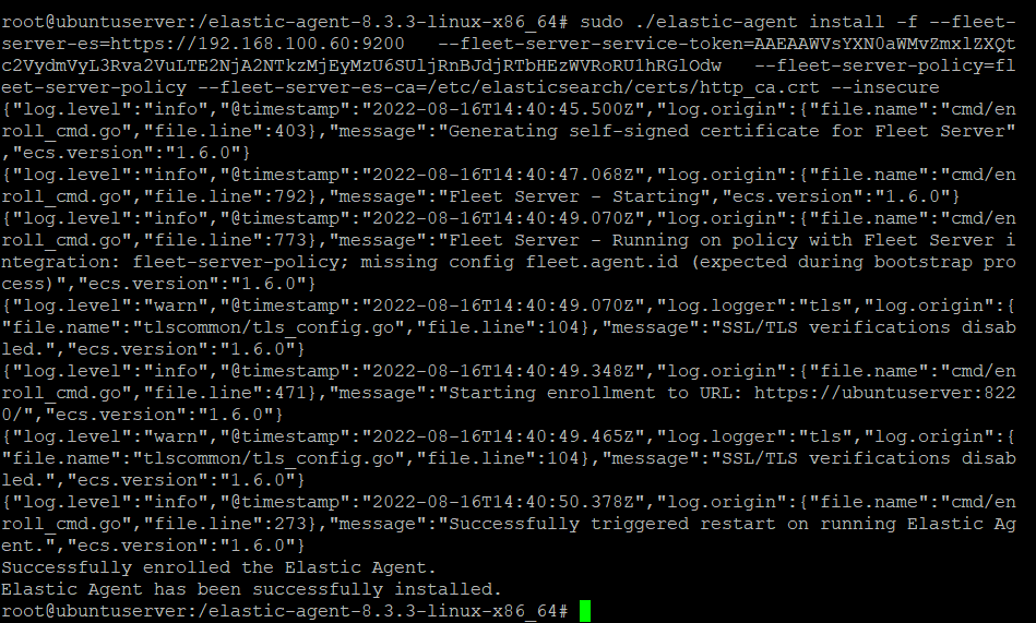

I can't connect my elastic agent to the fleet server

Hi, could you share what do you see in the logs when you try to enroll an agent? Did the command to start Fleet Server succeed?
The commands sounds ok because i dont have any error but when i see this logs?

It could be that Fleet Server can't communicate with Elasticsearch. You can verify the Elasticsearch host in Settings / Outputs / default output.
Can you try setting --fleet-server-es=https://192.168.100.60:9200 in your enroll command?
i try but have the same problem
If you visit http://localhost:9200/ , do you get a successful response? It would be good to find out where Elasticsearch runs.
If it really runs in http only, you have to add --fleet-server-es-insecure to the enroll command.
On localhost i dont have a successful response.
Now im trying --fleet-server-es-insecure.
Same problem
"Fleet Server - Error - EOF"
