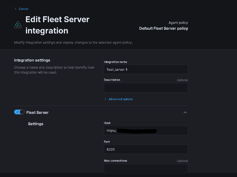

Some prints that can help:
I don't know how can I get the elastic-agent works and make the server listen on 8220. I've tried on logstash server too and get the same error: Error - listen tcp: address https://logstash.exemple:8220: too many colons in address
