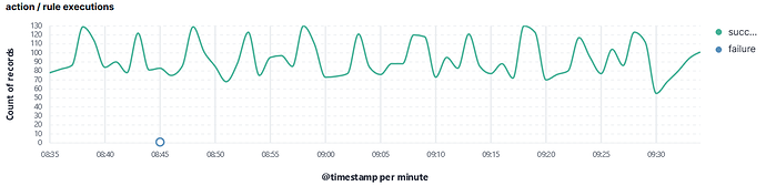

I have a been reconfiguring my elastic cloud setup to try and improve performance. I created a frozen tier node, alot of indices have moved from warm to searchable snapshots. However looking at the CPU of the frozen node i can see CPU spikes, these spikes coincide with spikes in alerts running and field_caps events on that node - Elasticsearch.audit.action: indices:data/read/field_caps[index][s]

Some metrics:

field_caps is not something i have run, just a events that i see on all of the nodes but trying to corrolate between the siem alerts running, events on the frozen node and the CPU spikes. Within the event, the field Elasticsearch.audit.indices lists all of the winlogbeat-00000xx indexes from hot, warm to frozen.
