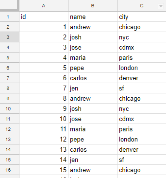

My data looks like this:

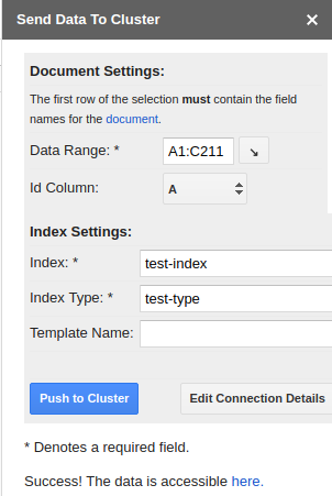

Also did you make sure to select a valid data range in your spreadsheet before pressing the button? Can you screenshot your "Send Data to Cluster" panel?
Hi @val,
I re-installed the template (exactly as previously, leaving in "test-template" at the start of the code. I still do not see any data in the index when pushing the table. Here is the screenshot:
It's weird, I've even tested this against a 6.1.2 ES cluster and it worked.
What do you see below the panel when you hit the "Push to cluster" button?
