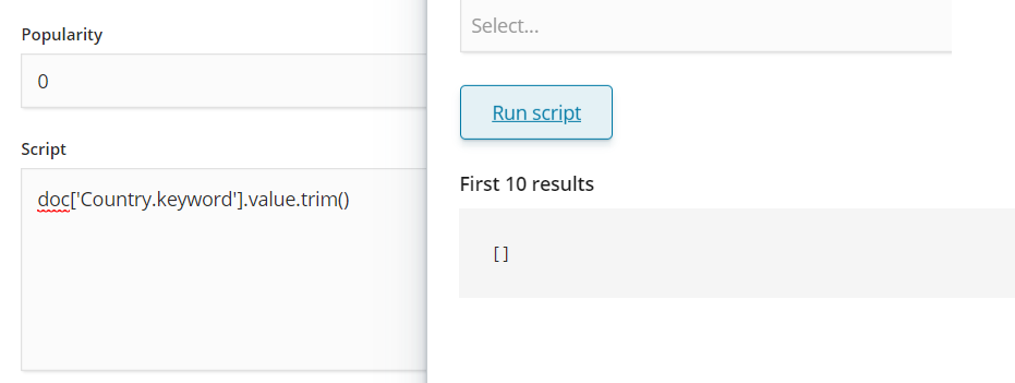

I'm pretty sure the city is a string field. See this example. I created "trim_field" without the trim function applied, the test is:
You can see the countries on the right, this is fine. I add the trim function and get:
No visible errors here.

Yes, painless scripting and string as in your pic above. I just added "Title case" transform at the end, since I have mixed "City", "city", "CITY" and so on. (Same for country and other details... bad data collection)
@LoZio The error that is occurring would happen if the script was run as the following: doc['Country.keyword'].value.trim
Is it possible the script was run this way previously? (without parens for the trim method)
Hi Jack, the images are from the actual run that generated the logs so the parenthesis are there
