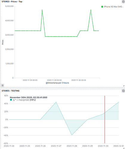

You could do it by using the metric "serial difference" and a "Date Histogram", it's not exactly a ratio like the one that you expect, but the other option will be timelion operating the two series. Hope it Helps.
Thank you so much Iker, i really need to calculate return between periods, daily, monthly... calculate de diference helps but i need the percentage of change, no way to do this?
Best regards
In theory you could use timelion to get the %, then use that data in Canvas so you could get a nice table, but the last part is beyond my capabilities:
Example of timelion params:
Visualization
