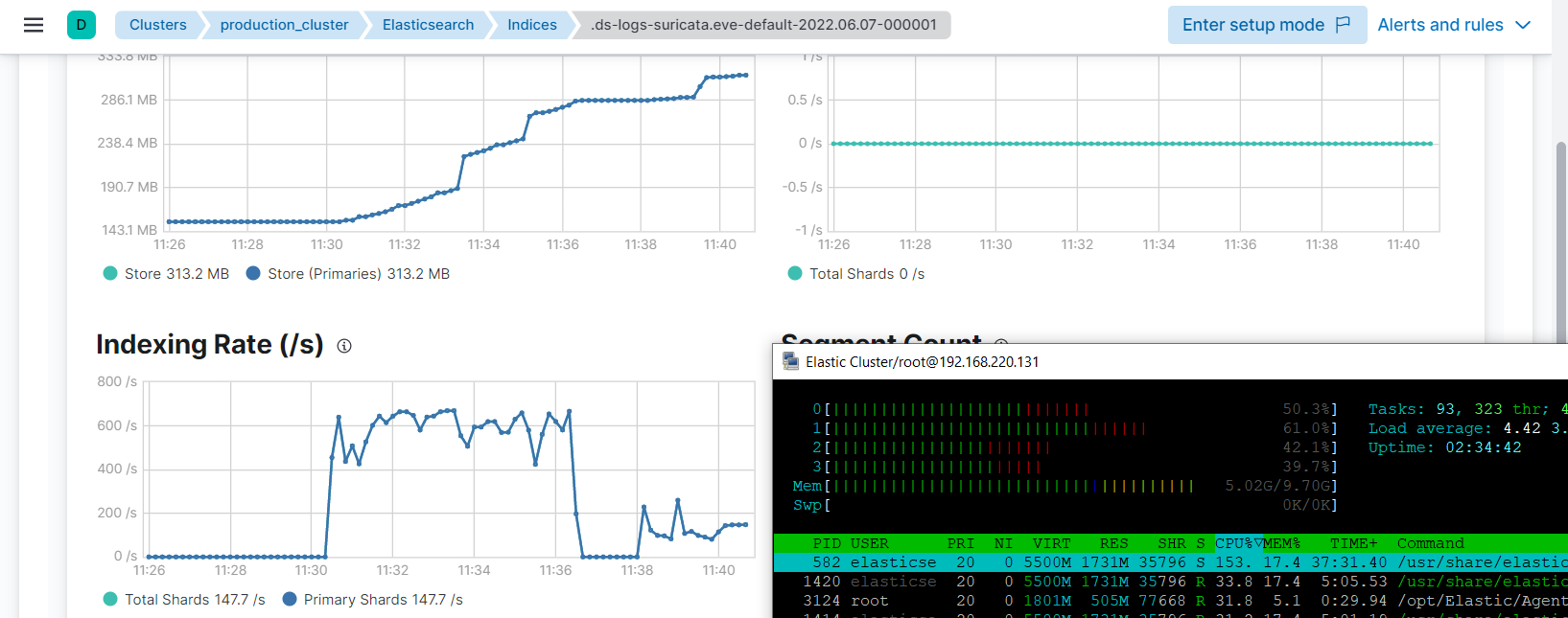

I came first and only received the Suricata log from the elastic agent, about 600 EPS processing is done. The amount of CPU that you can see in the following figure by htop command:
Then I came and processed other logs along with the Suricata log by the elastic agent (such as zeek, syslog , etc.). In this case, the processing EPS of the Suricata log dropped sharply (it became about 100 EPS) while the CPU usage rate remained the same:
This indicates that the number of pipeline threads is probably constant or that the elastic agent has a limited processing power.
