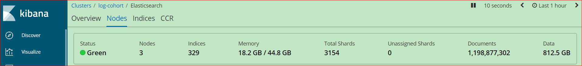

Below is Just a screen shot of the details of indices, shards and documents and data size.
You probably have too many shards per node.
