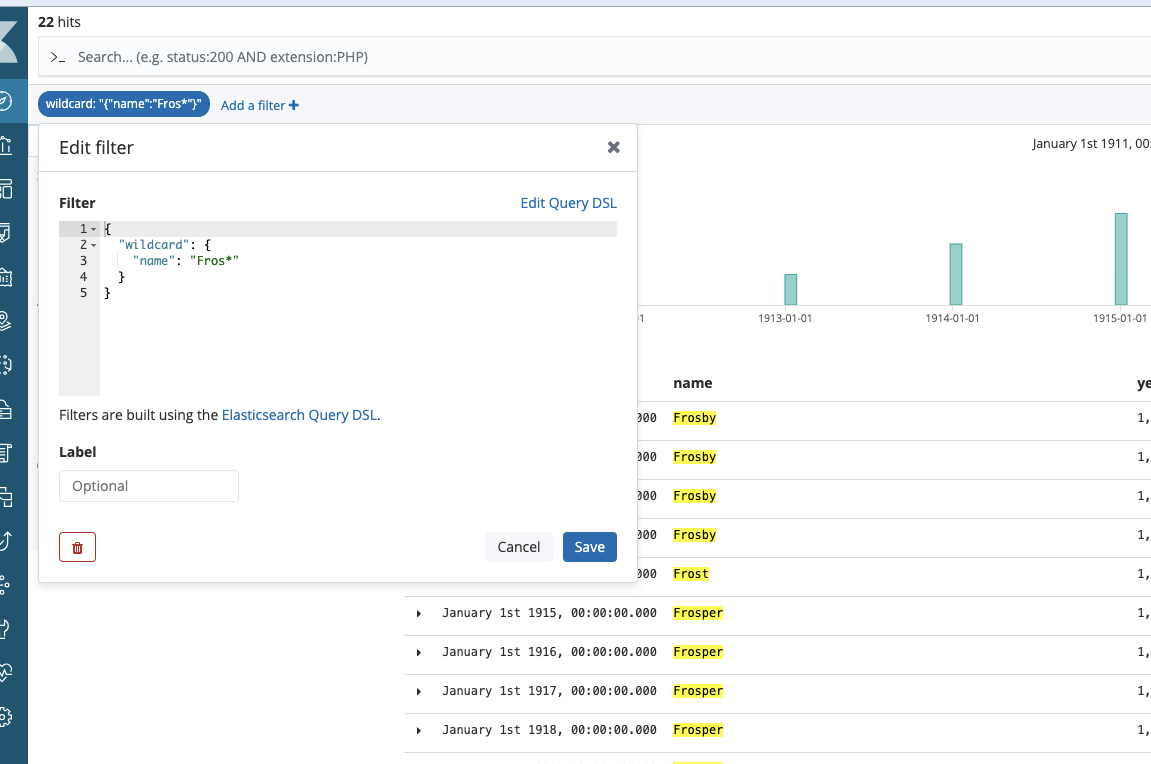

You can use a wildcard query to search for URLs that begin with the same address. For example:
pageUrl:http://example.com/*
You can also create a filter that can be saved into a search, or pinned and re-used across different Kibana apps:
It's recommended to use trailing wildcards only for searching for substrings. Leading wildcards have serious performance issues due to the fact Elasticsearch has to process the field from every doc.
