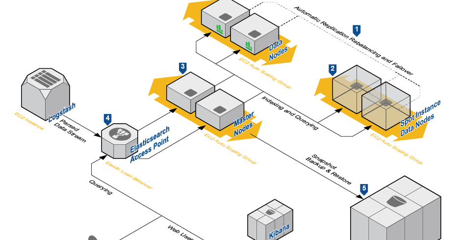

The setup to evaluate:
2 Core Nodes ("Always" available spread over to availability zones)
1 Spot Instance (Not always available)
Default index: 5 Shards, 1 Replica
That should really be possible (by some kind of filters similar to shard allocation), the shutdown of some instance types (spot instances) on AWS does only happen rarelly, so this would be a great way to improve costs...
There is one guy build something like this, but I think it's still not "safe" regarding the replica placement:
I think there is still the risk situation that one core node fails and at the same time the spot instance goes down = cluster broken...
Any suggestions?
Best
Steph
You shouldn't need to force particular nodes to only allocate replica shards here. There is no difference between the data stored on a primary and replica shard. The only difference is that Elasticsearch labels one of them as a Primary. If the primary shard disappears, the master node will change one of the remaining replicas of that shard to a primary. So if your 'spot instance' contained a primary shard and was shutdown, then a replica on one of the other nodes would be promoted to a primary.
As stated in the blog you linked to, you will want to set allocation attributes so that you can guarantee that at least one copy of every shard is located on a 'core node'
