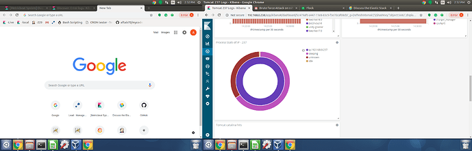

I tried many times to get the status of zombies process, I did not get a zombie process, I followed the steps, please help me.

Thanks for the reply, I created zombie process, which is showing in top command and on top, I can see running and sleeping process and I created pie chart given images above and I am getting running, sleeping, unknown process but I generated zombie process for testing purpose but i am not getting zombie process count in kibana, i am using metricbeat 6.3.2 version.
You can also see the status of zombie process on top.
I'm not an expert in the field but I think that in the screenshot of top you don't have any zombie processes:
You have:
S: interruptible sleep (waiting for an event to complete)
I: I guess it's BSD, in such case it means that it is multi-threaded (using CLONE_THREAD, like NPTL pthreads do)
R: running or runnable (on run queue)
I don't see any Z which is the state of a zombie process.
