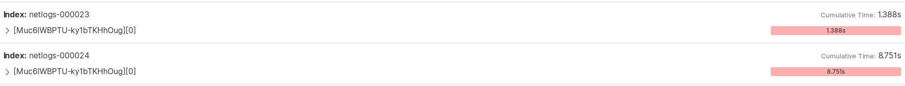

The profile results tell me that two indexes take the longest:
Query:
Aggregation:
