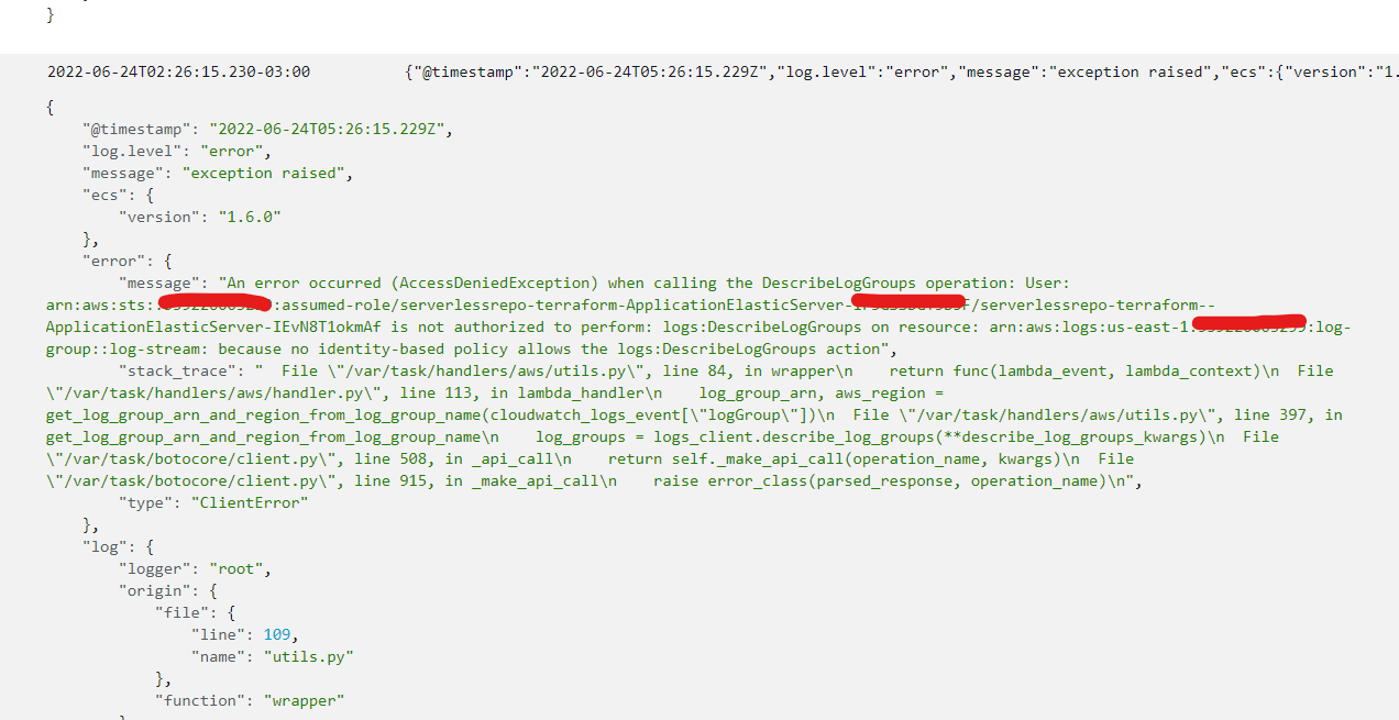

okay, I successfully implanted. But there is some permission adjustment required, see:
That is right?

Permissions are like this, it was added by deployment, I didn't change it
    "Version": "2012-10-17",
    "Statement": [
            "Sid": "VisualEditor0",
            "Effect": "Allow",
            "Action": [
                "logs:DescribeLogGroups",
                "s3:GetObject",
                "sqs:SendMessage"
            "Resource": [
                "arn:aws:logs:us-east-1:*****45454:log-group:/aws/lambda/condo-loan-asyc-dev-check-expired-order:*",
                "arn:aws:s3:::elk-config-sar-bucket-dev/sarconfig.yaml",
                "arn:aws:sqs:us-east-1:*****45454:elastic-serverless-forwarder-replay-queue-128e6a1cd335",
                "arn:aws:sqs:us-east-1:*****45454:elastic-serverless-forwarder-continuing-queue-128e6a1cd335"

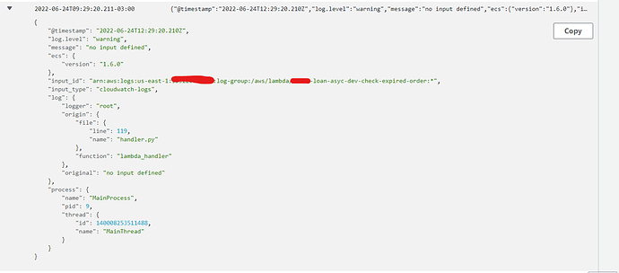

Now we have no error log, but no input yet in Elastic.
    "@timestamp": "2022-06-24T06:31:54.515Z",
    "log.level": "warning",
    "message": "no input defined",
    "ecs": {
        "version": "1.6.0"
    "input_id": "arn:aws:logs:us-east-1:*****45454:log-group:/aws/lambda/pod-loan-asyc-dev-check-expired-order:*",
    "input_type": "cloudwatch-logs",
    "log": {
        "logger": "root",
        "origin": {
            "file": {
                "line": 119,
                "name": "handler.py"
            "function": "lambda_handler"
        "original": "no input defined"
    "process": {
        "name": "MainProcess",
        "pid": 9,
        "thread": {
            "id": 139822395262784,
            "name": "MainThread"
this should be arn:aws:logs:us-east-1:*****45454:log-group:/aws/lambda/pod-loan-asyc-dev-check-expired-order
that's why the permission was give to the wrong resource:
vs
arn:aws:logs:us-east-1:*****45454:log-group:*:*
while this solves your current issue it is indeed a bug in the forwarder: the correct ARN format for cloudwatch logs log groups is the one you've provided, not the one expected by the forwarder, I will fix ASAP
Ok @Andrea_Spacca , thank you.
After the change the permission was given correctly. The permission issue is ok. But the data is still not sent, is this the BUG?

This will happen because the arn is incorrect, because the correct arn has the asterisk, correct?
if you haven't changed the config file from the last you pasted it should work properly (since it includes the trailing :*):
inputs:
  - type: "cloudwatch-logs"
    id: "arn:aws:logs:us-east-1:*****45454:log-group:/aws/lambda/pod-loan-asyc-dev-check-expired-order:*"

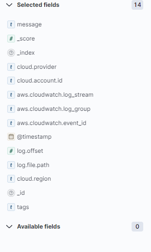

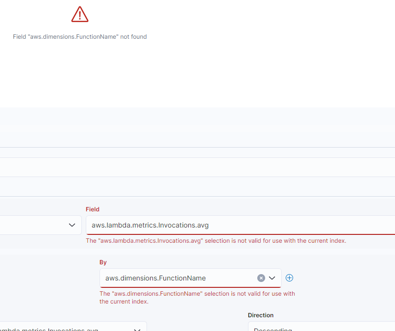

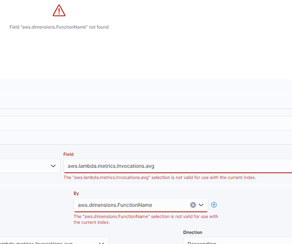

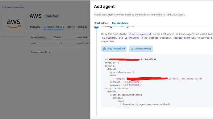

Now it's working. But what I wanted was lambda invocation metrics, errors, memory usage, but this integration doesn't provide this data. Do I have to do anything additional?
This image from asset dashboard AWS Lambda.
I even configured this integration, but it didn't bring data.
Do I need to configure this output somewhere in sarconfig?
@Andrea_Spacca @stephenb can you help me, please?
hello @Renato_Souza , sorry for the late reply
there is no serverless solution at the moment for metrics collection, you can collect them using the elastic agent

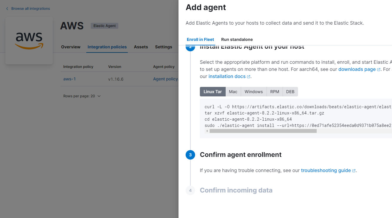

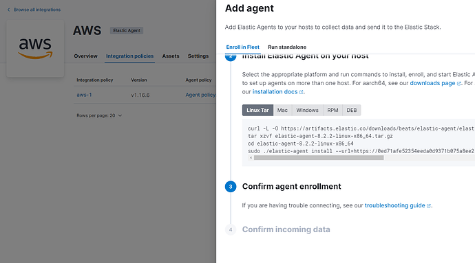

Can you use elastic agent in a lambda? Which document should I use? It would be really cool to have invocation lambda metrics. The integration shows this data, I imagine it is possible. If you tell me the way, I'll look for it. Thanks
you cannot run elastic agent in a lambda, you can install it anyway on an ec2 instance through fleet or as a standalone agent
with this I can recover data from lambda, innovations and etc? In this case, would you use elastic's native integration with aws and fleet?
consider the elastic serverless forwarder as an alternative to elastic agent AWS S3 input (it has also other native AWS inputs indeed), in regards of logs collection
for metrics collections only elastic agent is available
in both cases you should rely o the AWS integrations available in kibana: only installing the assets in the case of the forwarder, adding the full integration in the case of elastic agent
