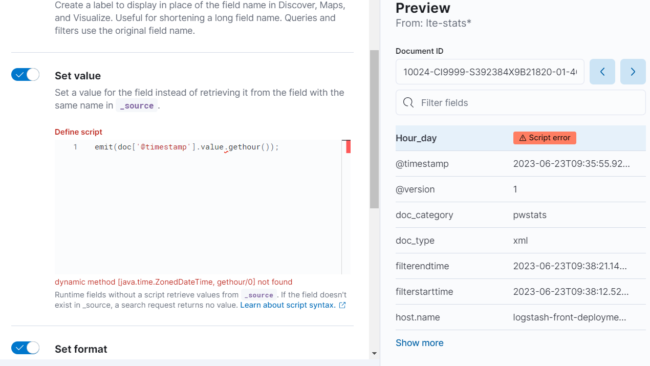

Do you mean that you want to have a date histogram chart but the chart is skipping some time of the day? Unfortunately this is not possible, but there is a workaround that can serve you but only for one day at the time. You could set up a runtime field hour_of_day:
and then, instead of date histogram (which has a continuous character and unfortunately we cannot skip some periods) you could do filters visualization. Bear in mind that this can be performance heavy, so make sure it's not straining your Kibana too much. You can add labels to your vis to make it look more like a date histogram. This, as I mentioned before will work only across one day because otherwise the values will be summed.

Unfortunately, I am getting this error when creating scripted field as given by you
or
after giving semicolon too
Try correcting it to getHour() (capitalized 'H')
Thanks @Marta_Bondyra
I am able to draw graph now
