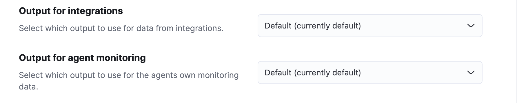

OK, so based on the advice @stephenb and @leandrojmp have given, I think I need to do this:
  1. Go to Fleet -> Settings
    ( kbn:/app/fleet/settings )
  2. Go to Outputs section. Right now, I only have one Output, labelled default:
  1. Click on Add output to add another output
  2. In the new output go to Advanced YAML configuration, add the settings for bulk_max_size and compression_level there:
  1. Go to a particular agent policy
    Fleet -> Agent policies
    ( kbn:/app/fleet/policies/{policy id} )
  2. Scroll down to Output for integrations
  1. Change this output to point to the output I created in step 3.
Some of this is documented at Advanced YAML configuration
Does my understanding of the necessary steps seem right?
@leandrojmp @stephenb Do the steps which I have described above seem right?
Not sure what I could add, this is exactly what it is present in the documentation.
If you want this to just some agents you will need to first create the new output with this configuration, then create a new policy and use this output.
