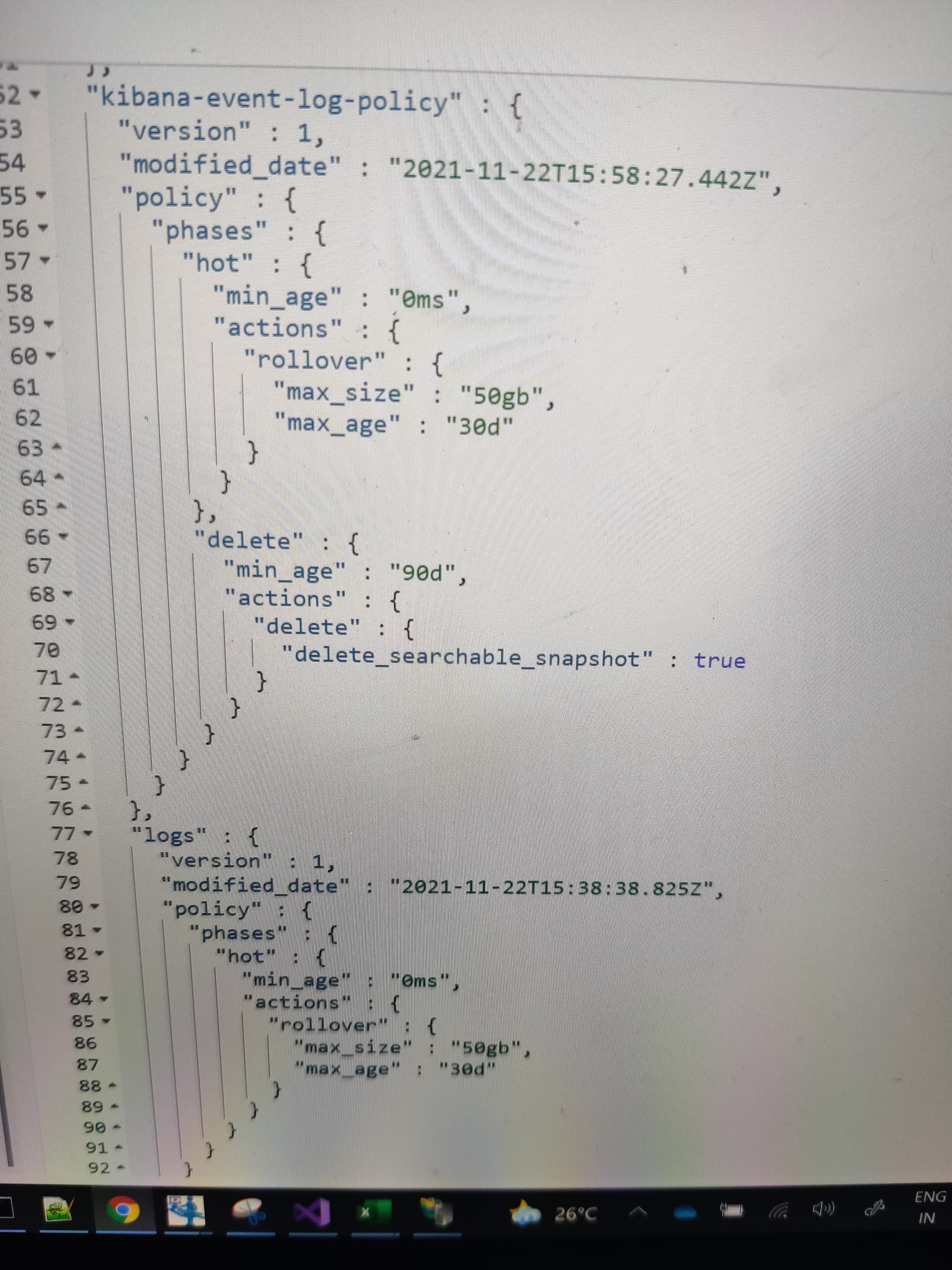

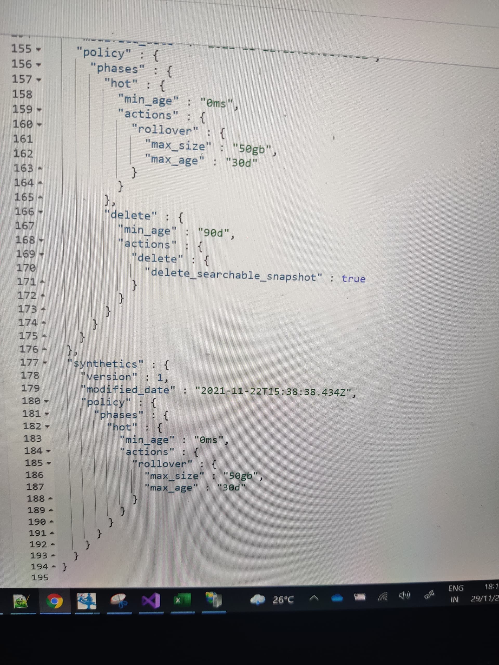

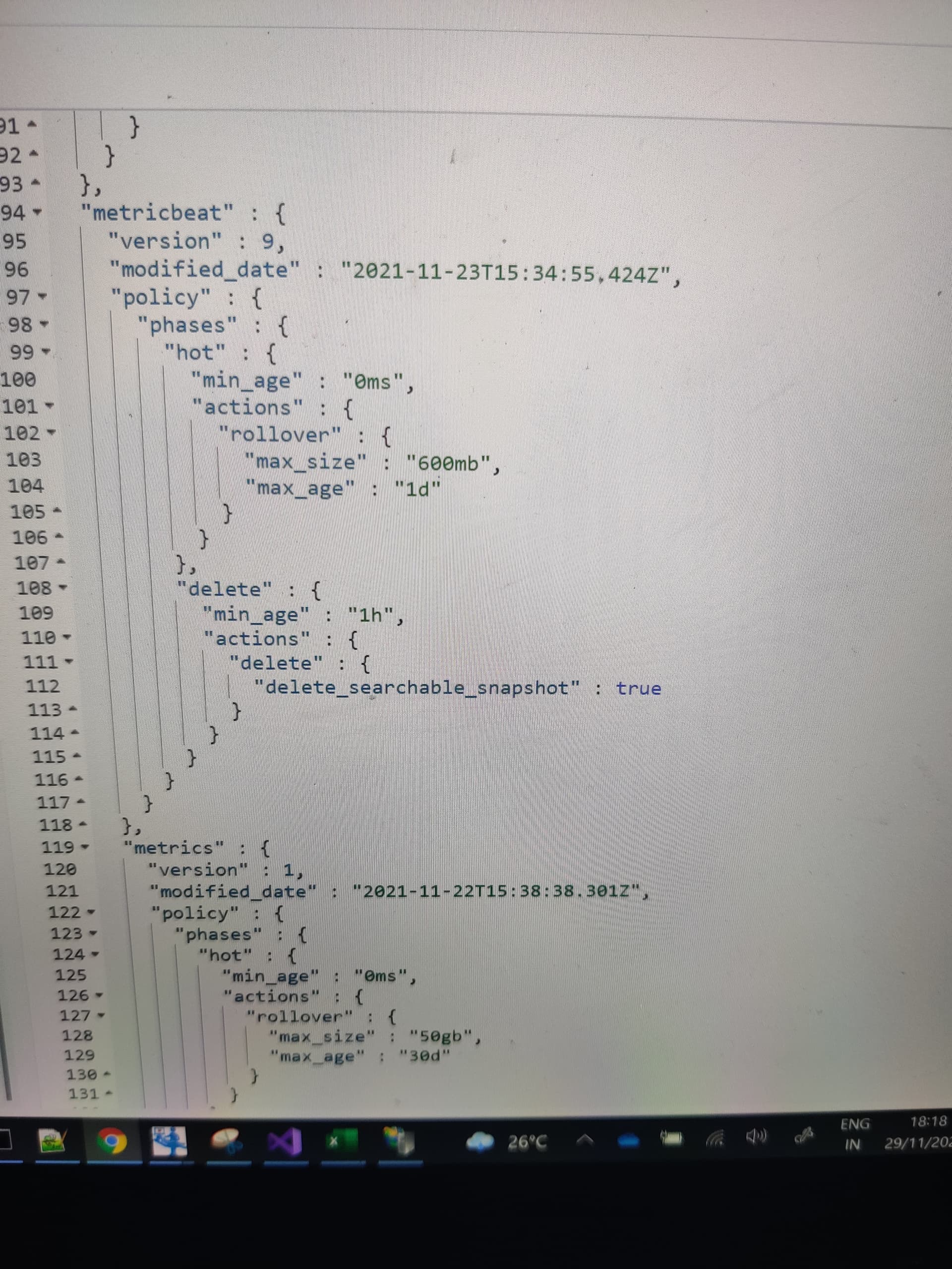

Created an ILM policy for metricbeat index to do a rollover and delete the index after it crosses 5GB.
ILM is doing the index rollover and deletion but still we are not able to get back the disk space back.
Eventually disk percent used is increasing each day and after few days, disk is completely filled up.
Why ILM policy is not deleting the data and reclaiming space?

Then I am able to delete the data and spin up the containers again. Otherwise ILM even after doing the rollover and delete, it is not reclaiming the disk space back. Please find the below snaps:
They are tiny 57mb... certainly not 7.6GB... .what is going on ....
Ahhh the 7.6GB disk usage being reported by Elasticsearch Cat Nodes / Allocation reports on the Docker Disk Container Filesystem that Elasticsearch is running in NOT the Host local disk...
So you will never see the Local Host Disk usage from Within Elasticsearch Running inside Docker... It can...not...see... it.
Elasticsearch only see the "local" filesystem which is docker owned... nothing Elasticsearch can do about that.
