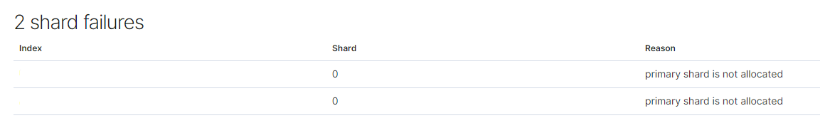

But after restore snapshot on southeastasia, No snapshot restored status and Index Health is red.

If your cluster health is red you should always start from the allocation explain API. Here is a blog post about diagnosing red health:
@DavidTurner
Thank you for your reply !
I found some plugins are not installed on southeastasia deployment.
After install plugin, restore is succeeded.
