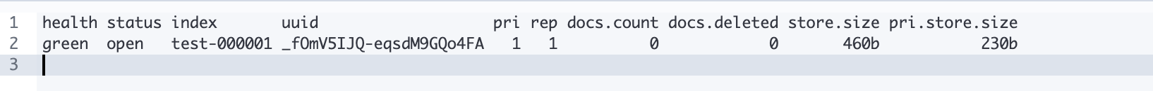

Actually I justed tested your example on 7.3.1 and it works as expected.
Can you show a full recreation including all the responses?
 PUT test-000001
      "aliases": {
      "test": {}
POST test/_rollover
  "conditions": {
    "max_size": "0gb"
  "mappings": {
    "properties": {
      "ts": {
        "type": "date"
  "settings": {
    "index.number_of_shards": 2,
    "index.sort.field": "ts",
    "index.sort.order": "desc"
I might give 7.3.1 a try.
Yup. Just confirmed 7.3.1 works.
