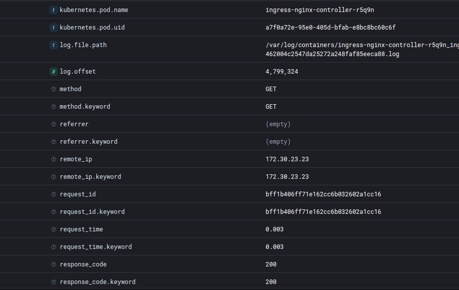

in my discover some fields doesnot index that you can see in below image:
my question is how can I index all these fields so can apply filtering in my searches
Welcome to our community! :smiley:
What makes you say they are not indexed?
Thanks for your response , I deleted the ilm and index template and created them again and my issue has been resolved , Thanks
