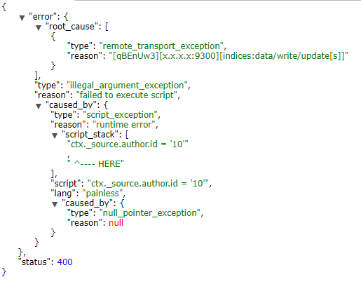

I have run UPDATE API from elastic by using this :
http://esURL/index/type/idcontent/_update POST
      "script": {
        "source": "ctx._source.author.id = '10'",
        "lang": "painless"
I got this error:
Any Idea how to do it ?
Thank You
What does your document look like before the update? Does it actually exsist? Does it have an author field which is an object?

Then you'll probably want to read about upserts. https://www.elastic.co/guide/en/elasticsearch/reference/current/docs-update.html#upserts
Thank you so much ! Yes, I can insert object type into my created document.
By using : https://www.elastic.co/guide/en/elasticsearch/reference/current/docs-update.html#_literal_doc_as_upsert_literal
Thanks a lot
