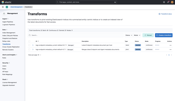

Alternatives to the above are to add the transforms you need manually through the Transform API. Or you can also add transforms through the UI at "Stack Management > Transforms"
You will still be able to install a transform using latest. You will also need to install your destination index. You can try either the UI or the API mentioned above. You can also take a look at this tutorial for more guidance on how to manually install transforms.
