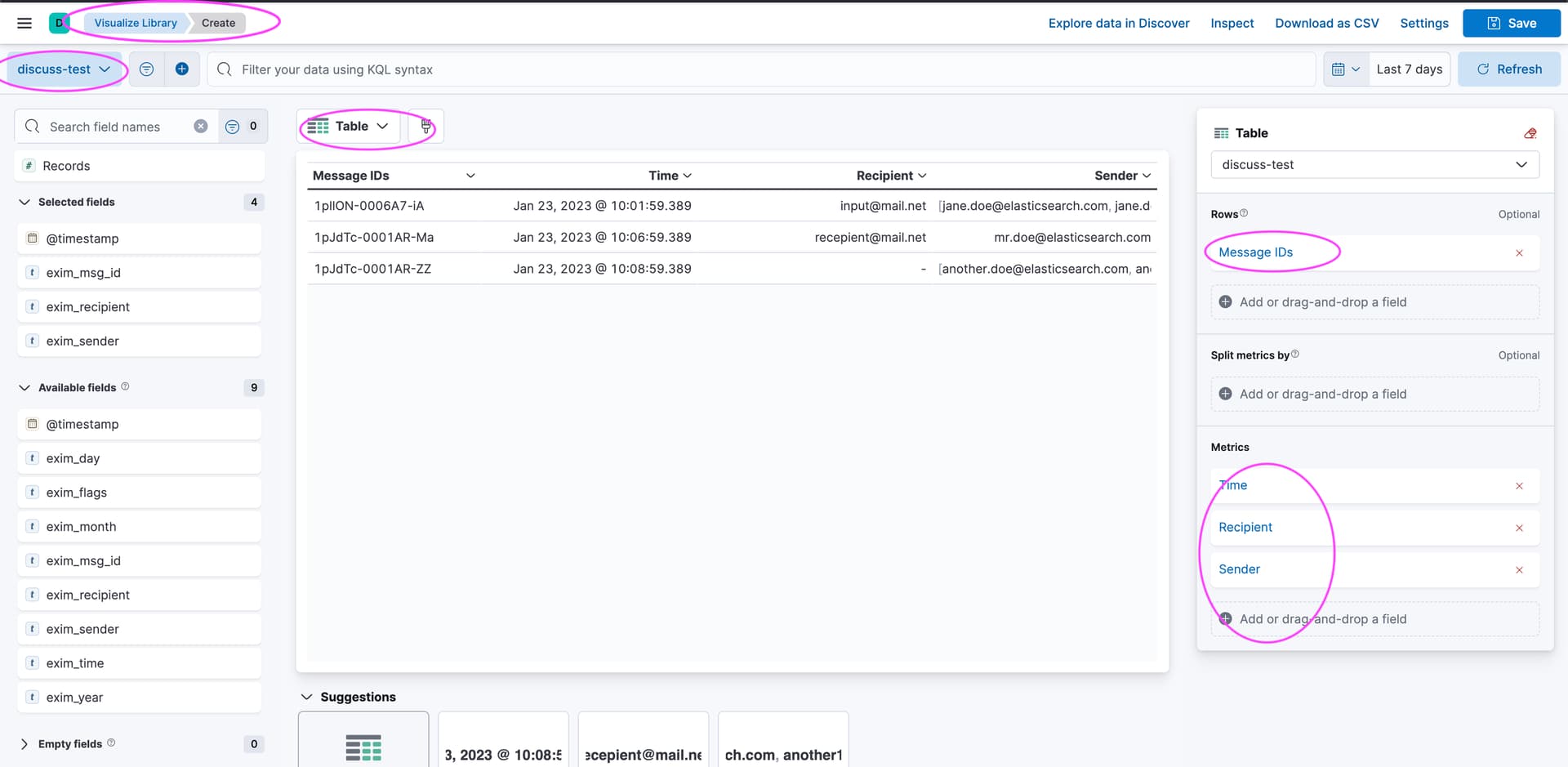

Hi @moep
Ok so here is a potential solution... see if you can follow along... this is not perfect but perhaps a start.
Note this is a possible solution not saying it is perfect....
Sample Data
DELETE discuss-test
GET discuss-test
PUT discuss-test
  "mappings": {
    "dynamic_templates": [
        "strings": {
          "match_mapping_type": "string",
          "match":   "exim*",
          "mapping": {
            "type": "keyword"
POST discuss-test/_doc
  "exim_year": "2022",
  "exim_month": "12",
  "exim_day": "26",
  "exim_time": "08:15:43",
  "@timestamp": "2023-01-23T18:00:59.389Z",
  "exim_flags": "**",
  "exim_sender": [
	"jane.doe@elasticsearch.com",
	"jane.doe@elasticsearch.com"],
	"exim_msg_id": "1pIlON-0006A7-iA"
  "exim_time": "19:00:52",
  "@timestamp": "2023-01-23T18:01:59.389Z",
  "exim_day": "22",
  "exim_flags": "==",
  "exim_month": "01",
  "exim_recipient": "input@mail.net",
"exim_month": "12",
"exim_day": "26",
"@timestamp": "2023-01-23T18:05:59.389Z",
"exim_flags": "**",
"exim_sender": "mr.doe@elasticsearch.com",
"exim_msg_id": "1pJdTc-0001AR-Ma"
	"@timestamp": "2023-01-23T18:06:59.389Z",
  "exim_day": "22",
  "exim_flags": "==",
  "exim_month": "01",
  "exim_recipient": "recepient@mail.net",
	"exim_month": "12",
	"exim_day": "26",
	"@timestamp": "2023-01-23T18:08:59.389Z",
	"exim_flags": "**",
	"exim_sender": ["another.doe@elasticsearch.com","another1.doe@elasticsearch.com"],
	"exim_msg_id": "1pJdTc-0001AR-ZZ"
Then I created a Data View....

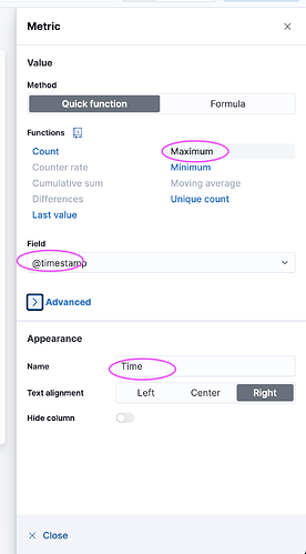

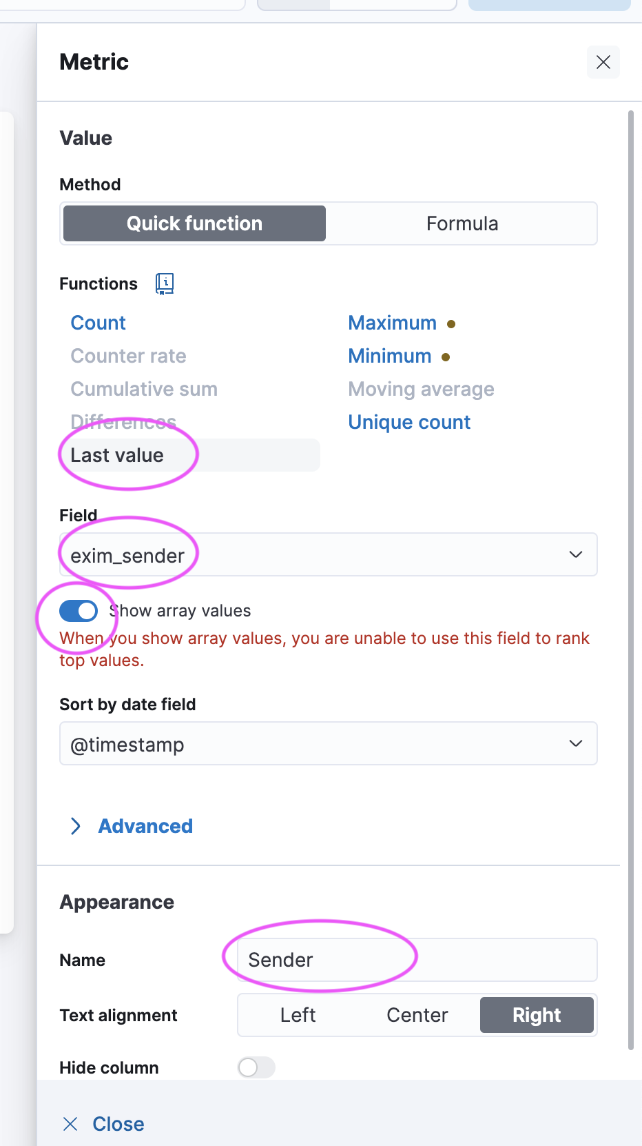

Then I created a Lens -> Table
Overview
Row -> Time
Max Time
Last Recipient
Last Sender

@stephenb right now, your answer is the best answer, but there is one thing, where Im not sure, how to solve it:
The filter only shows the last entry at exim_recipient, which is ok in ~90 % cases, but when I'm writing to an e-mail list, the MSGID is for all recipients is similar. I was thinking about Formulas, but not sure if they work in a table (yes I was reading the docs, but I didnt found an example for me case).
