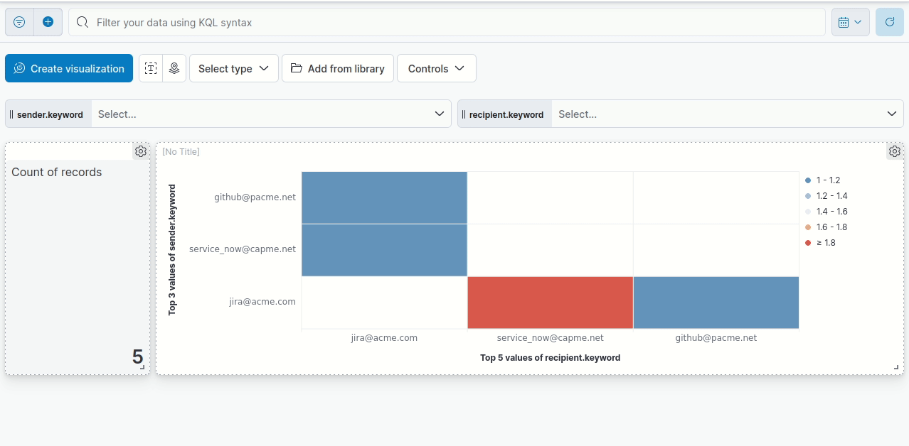

Can you share a screenshot or recording of what you are trying to achieve?
I added some sample data on 8.5.0 and created a dashboard and I can't replicate the error
Test data

Recording of a dashboard with controls
Peek 2022-12-27 18-38
Does this help?

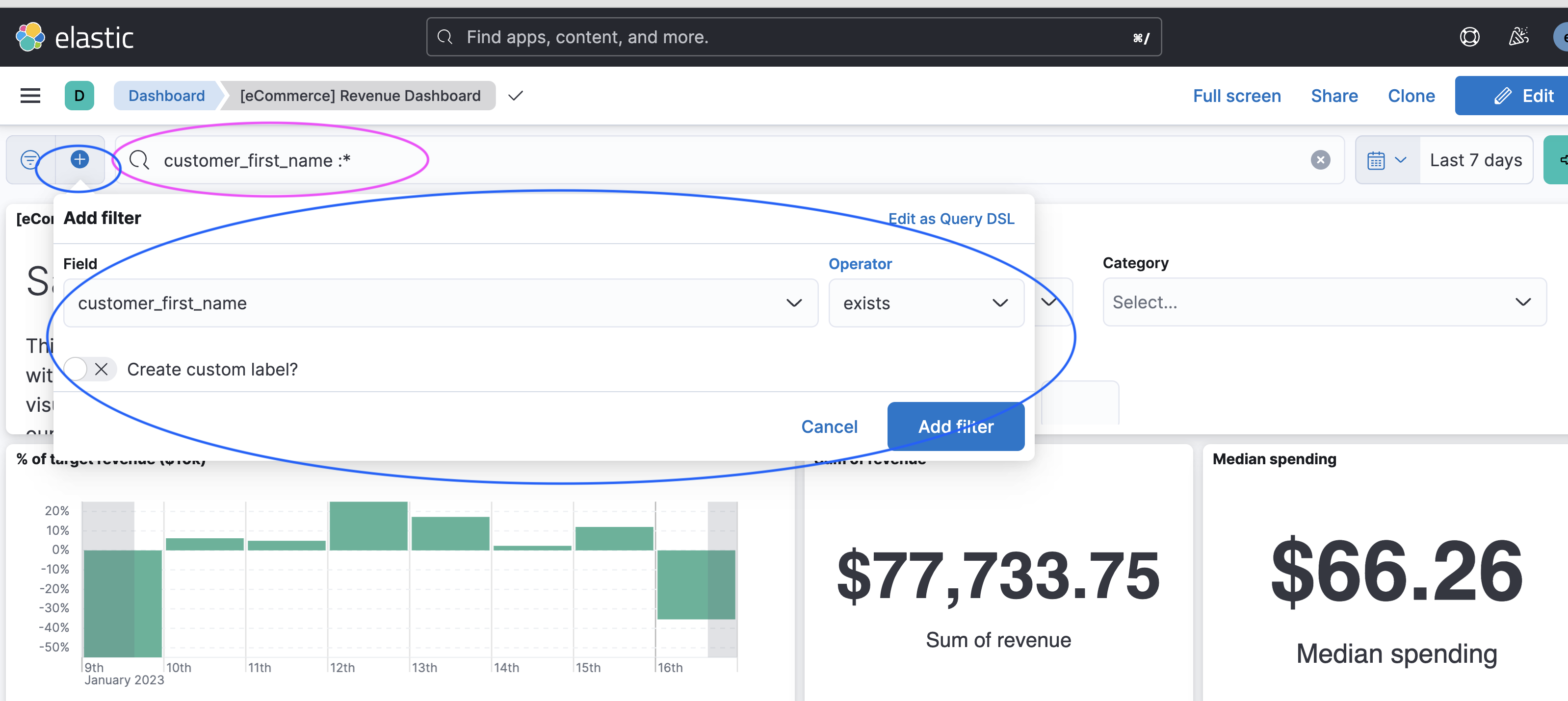

Hi am a bit confused you can either:
  • Put the filter / query in the KQL bar as you defined (Pink Oval)
  • Or you can create a filter with exist (Blue Ovals)
You do not need both.

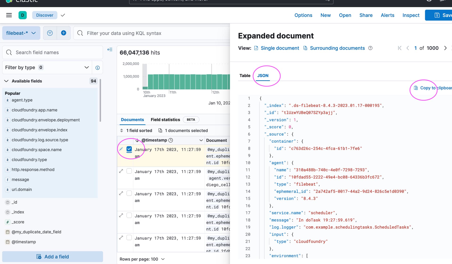

where can I find the JSON view in Elastic, that I can share it?
thx
Kibana -> Discover, Select a Document, and Look at the JSON
Just to be sure:
Mark at the right side (mouse over: Click or hit enter to interact with cell content) and then Copy to clipboard in JSON structure?
Make sure you include a couple documents...
