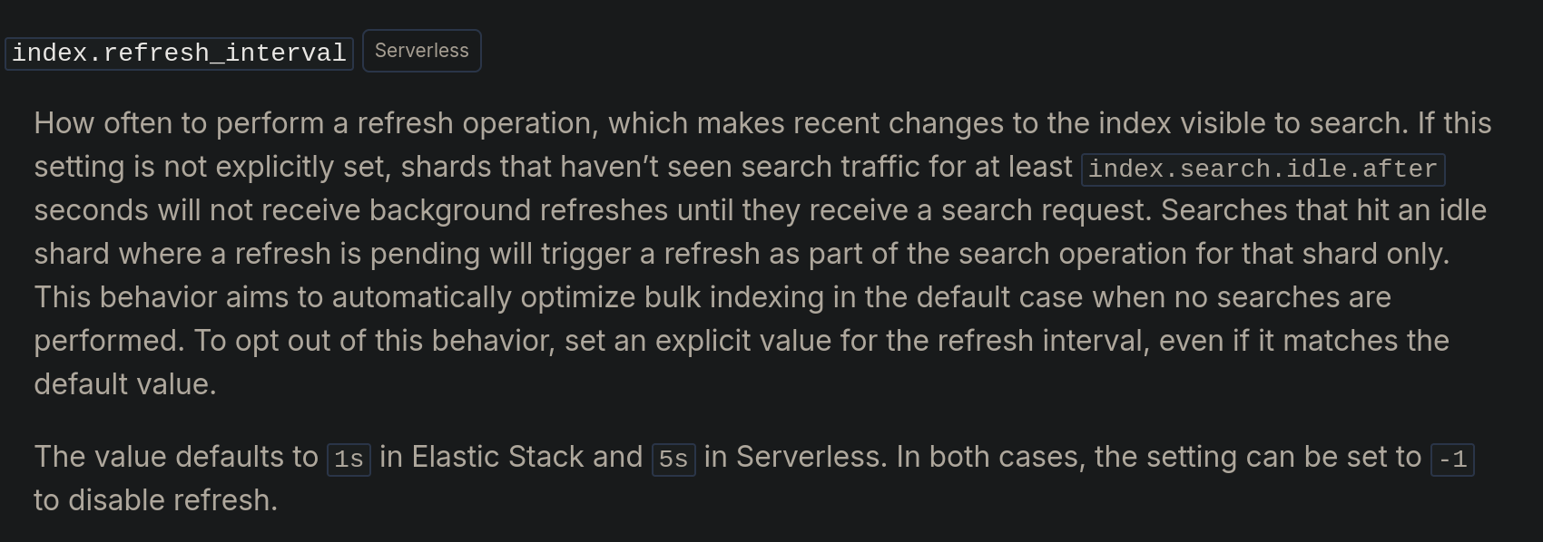

Here's the documentation for index.refresh_interval which explains more in depth how it works, from the settings documentation:
