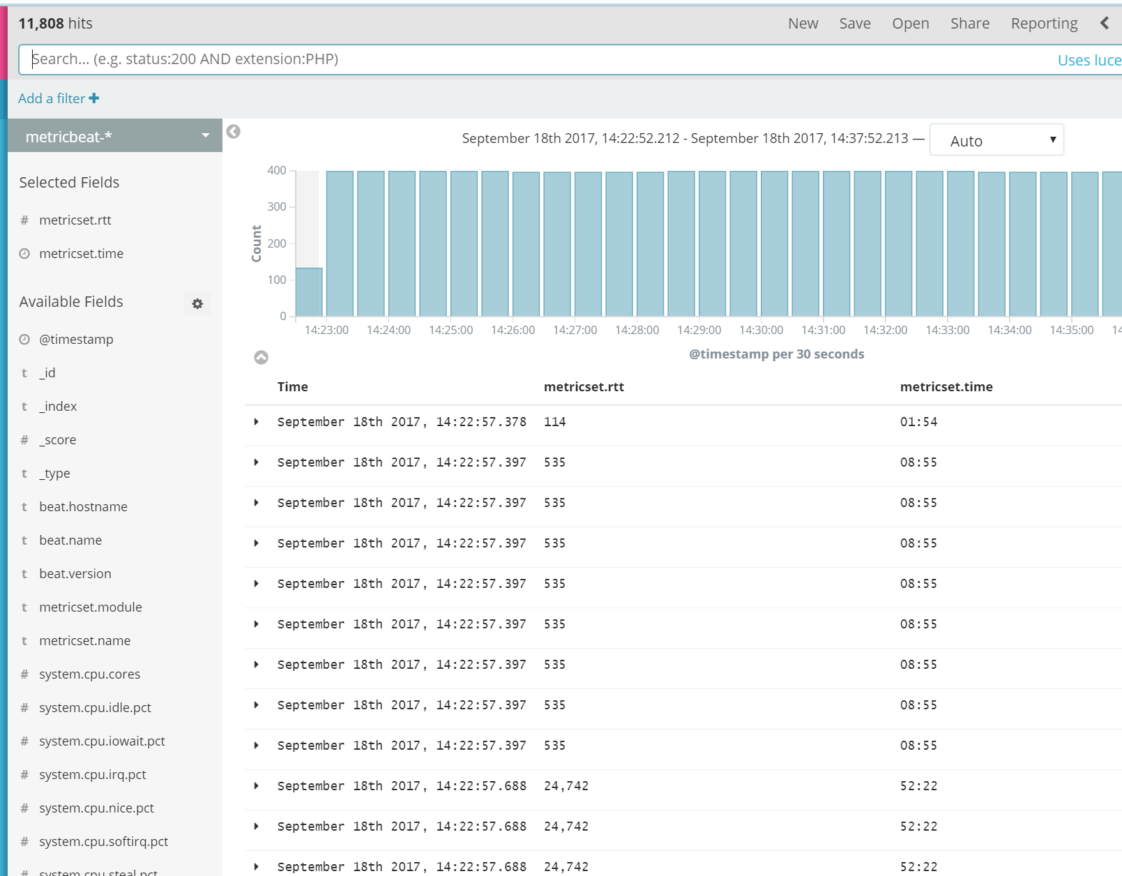

In the screenshot below, I used some number type field metricset.rtt and used it in a scripted field of type date.
I set the Format to Date, and the pattern to minutes:seconds mm:ss. I guess it assumed the value was milliseconds so I multiplied by 1000. I named my scripted field metricset.time
Now in Discover I can add both the original metricset.rtt and my scripted field metricset.time so I can check that the calculation is working as expected.
You could easily change it to HH:mm:ss or create another scripted field with that formatting.
