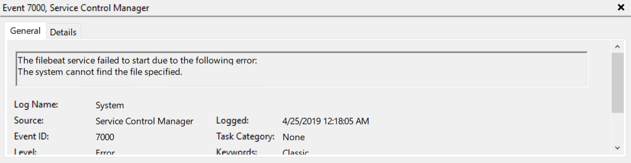

are there any processed logs (by filebeat) ?
Yeah, two like this:
