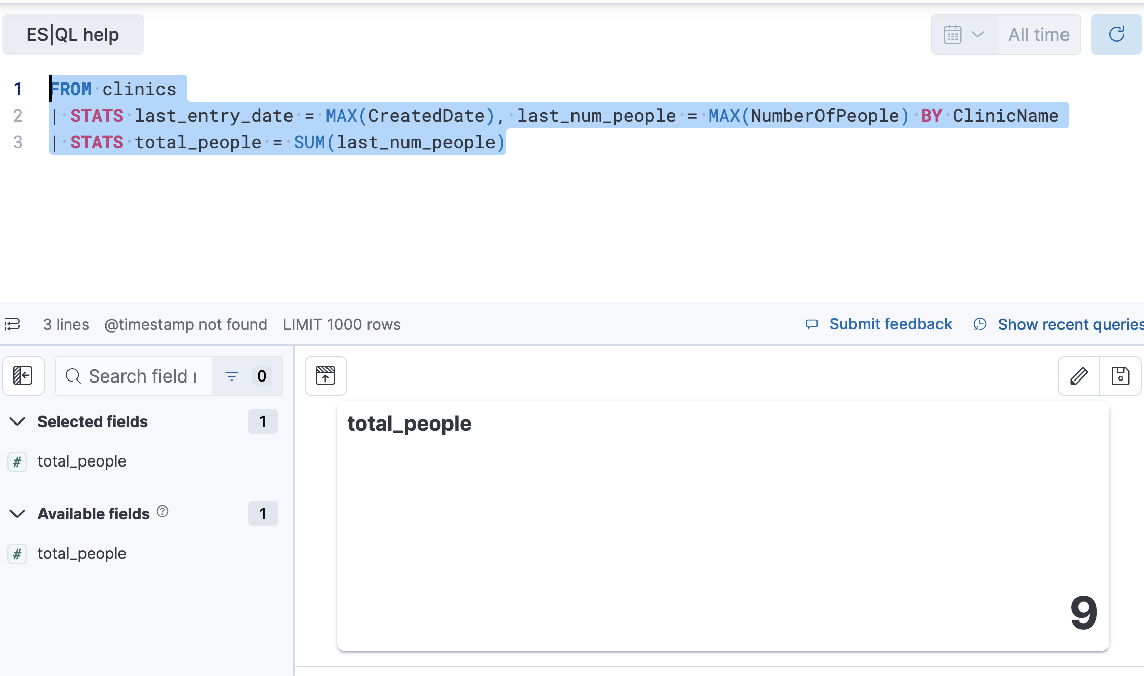

Or run the first 2 commands and then go to discover ...
FROM clinics
  | STATS max_num_people = MAX(NumberOfPeople) BY ClinicName
  | STATS total_people = SUM(max_num_people)
Technically that just takes the sum of the max which may work.

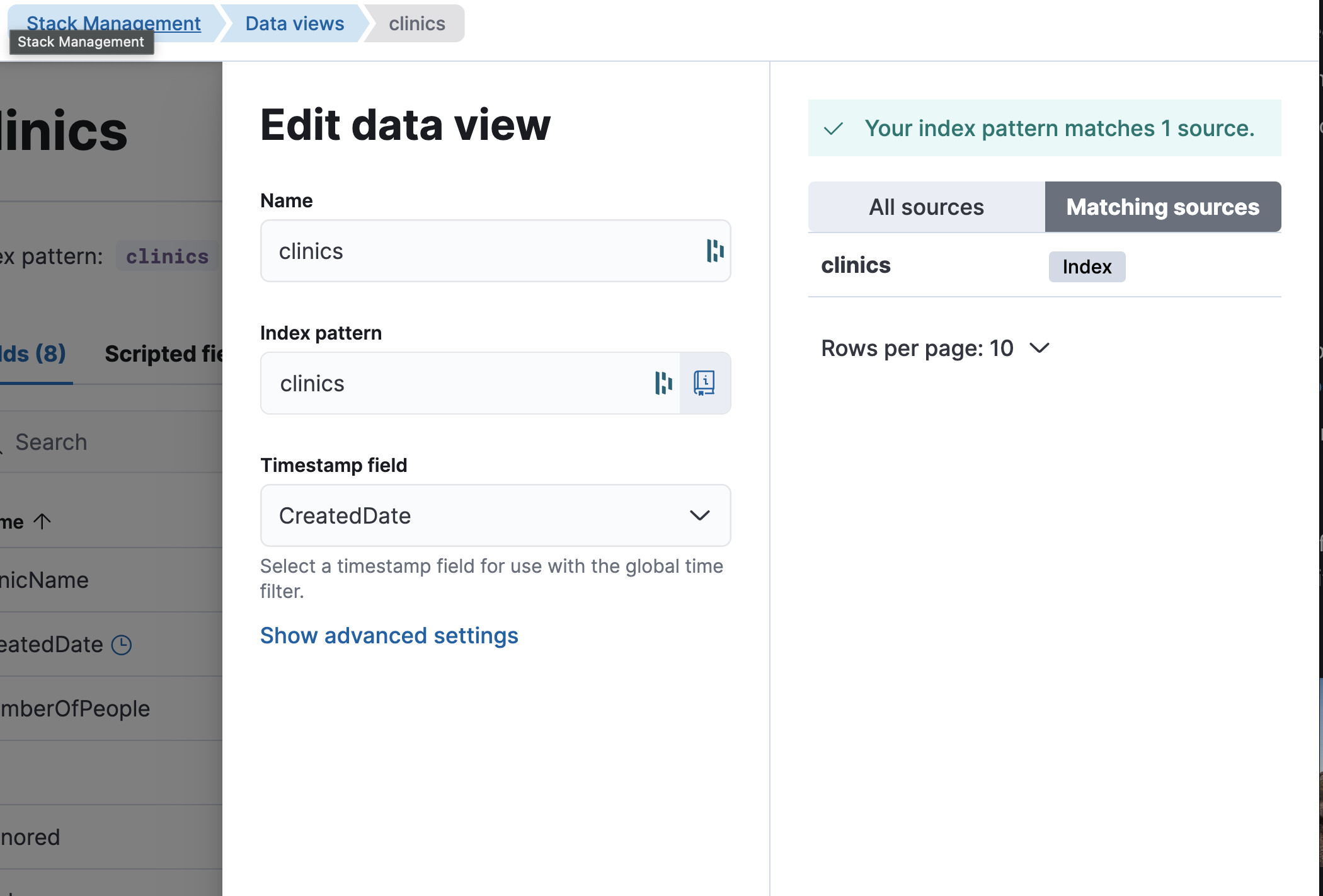

In Lens you will need to create a data View with
Then Create a Lens Metrics

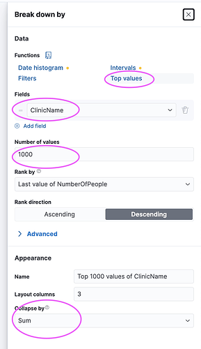

We will get the last value of NumberOfPeople for each Clinic Name and then Sum Them
Primary Metrics
Last Value : NumberOfPeople
Then Breakdown by Top Value ClinicName
1000
Then Collapse by Sum
Hope This Helps

Thank you again @stephenb for this great response.
I was very close to getting it right but I needed the MAX(NumberOfPeople).
I've learnt quite a few things from your full response, much appreciated.
