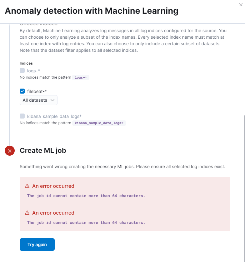

Hello, I'm trying to create a ML job to test the anomalies feature with observability, the Log rate job was created successfully, but when I try to create a "Categorization" job it's saying "The job id cannot contain more than 64 characters", and there is no text box to enter job id ti bypass this limitation, I am using elk stack 7.17. How to solve this, please? Thanks.

where ml-team is the name of the Kibana Space I created it in. However, if I try to create the job in a Kibana Space name that is longer (i.e. my_really_really_really_really_really__really_long_name):
Then when I create the same job it'll get the same error as you (also notice error in background):

Thank you @richcollier for your answer, indeed seems a bug, but the problem is I already created an ML job of type "log rate" and the id of the job was 67 characters. And doesn't let me create a job of type "Categorization". it's weird! :confused:
