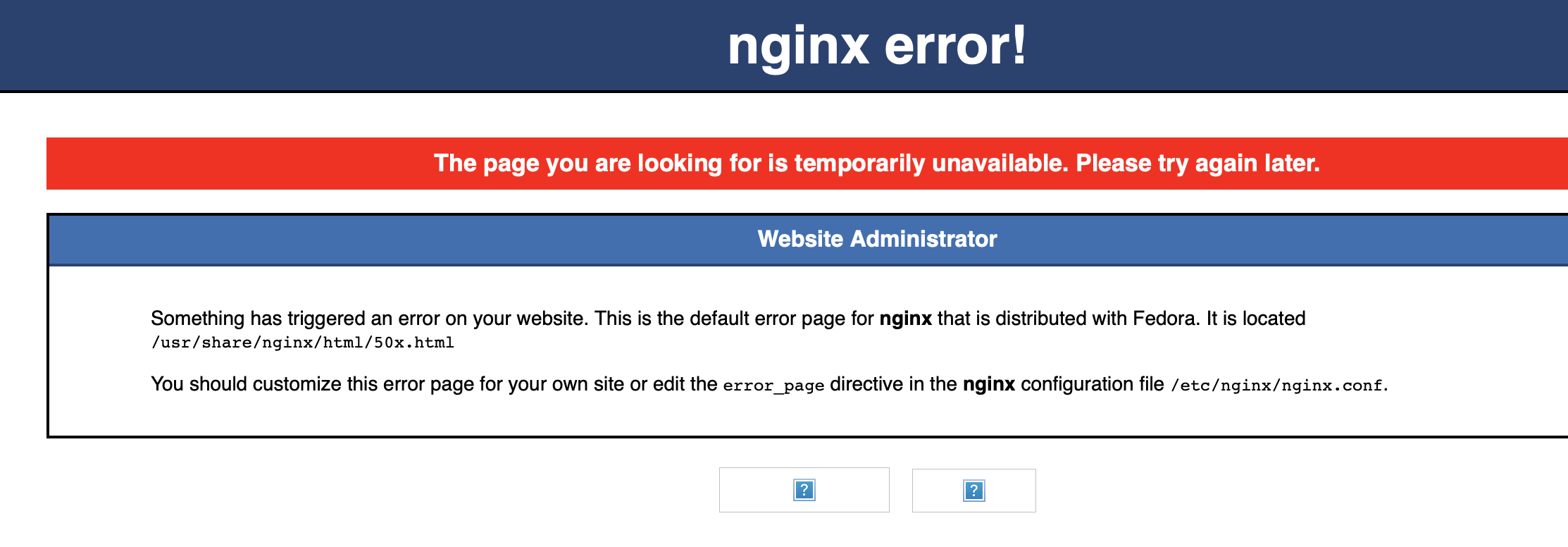

When I access Kibana using the 5601 port and create a shortened URL and share it, the shared shortened URL works fine when it is launched.
But when I access Kibana using http://kibana_url which is via Nginx and create a shortened URL and share it, the shared URL returns page not found.

Except for the short url, everything else works fine when accessed via Nginx Reverse Proxy i.e. http://kibana_url.

Was able to fix this issue by adding proxy_buffers to nginx.conf file.
In Nginx logs, I could see the following error:
2020/06/15 08:37:32 [error] 2213#0: *111259 upstream sent too big header while reading response header from upstream, client: 1.1.1.1, server: node00.foo.bar.com, request: "GET /goto/abracadabraabracadabraabracadabr HTTP/1.1", upstream: "http://2.2.2.2:5601/goto/abracadabraabracadabraabracadabr", host: "node00.foo.bar.com"
I also found that the short url is working for a small visualization but not for a huge dashboard. This correlates with what the error says above that the data chunk is huge.
So, following this SO link, I added the following to my nginx.conf under location block:
    proxy_buffer_size          128k;
    proxy_buffers              4 256k;
    proxy_busy_buffers_size    256k;
Restarted Nginx and all works fine now. The goto link works.
