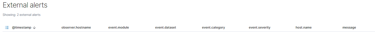

Hello,
Just wanted to confirm I got this working. But I noticed that there seems to be no way to define which columns are shown currently?
The default column list is very unlogical..
First of all observer.name isn't even an ecs field. Also I need to observer.hostname to be the first column. I can configure this:
But when reloading the page, everything is reverted to the default column setup? Or am I missing something?
Grtz
Willem
