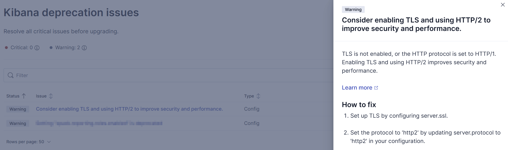

Hi everyone,
I'm using NGINX in my ELK Stack 9.0.1 self-managed instance and the Kibana (version 9.0.1) warns me about considering of enably TLS and using HTTP/2:
Following the "Learn more" link, I should insert inside the Kibana configuration yaml file this settings:
server.protocol: http2
server.ssl.enabled: true
server.ssl.certificate: "path/of/cert.crt"
server.ssl.key: "path/of/cert.key"
server.ssl.keyPassphrase: "<hiddenPW>"
When I restart the Kibana service, it won't boot up.
So my question is:
Should ignore the upon Kibana warning as I'm using NGINX for having a secure connection namely with HTTPS? If yes, how to disable the upon warning (only this warning, not all the warnings)?
Thanks!
Gabriele

Hi @RainTown
This, see Kibana logs:
Jun 25 07:47:07  kibana[950682]: [2025-06-25T07:47:07.656+02:00][ERROR][plugins.encryptedSavedObjects] Failed to decrypt attribute "apiKey" of saved object "alert,74874100-eb51-16te-9344-c185obr74106": Unsupported state or unable to authenticate data
Jun 25 07:47:07  kibana[950682]: [2025-06-25T07:47:07.659+02:00][ERROR][plugins.encryptedSavedObjects] Failed to decrypt attribute "apiKey" of saved object "alert,7442g100-eh71-14ae-9964-c172ubr76566": Unsupported state or unable to authenticate data

Maybe something related with the apiKey? I have two API keys configured (before settings the Kibana ssl settings)
Yes sure, I also want to secure the connection (indipendently if a private or business project, security goes first), but the settings that I'm configuring inside the Kibana config file, are similiar settings already set inside the nginx.conf file. The NGINX does already do the reverse proxy from an unsecure connection namely HTTP to HTTPS. The nginx configuration file does already contain the path of the ssl cert, key and key passphrase.
For this reason, as I'm using NGINX, configuraring the upon Kibana ssl settings, would secure at a very high level the security of the ELK Stack instance (I mean Kibana ssl + NGINX ssl) or the NGINX reverse proxy does already do what the ssl settings inside the Kibana config file will already do?
Is Kibana with SSL working when you try to connect direct to it, without having Nginx in front of it?
You need to make sure that the SSL configuration in Kibana is working when you connect direct to it, then you can see what you need to configure in Nginx if you still want to use it.
Nginx is not required, you can use just Kibana if you want.
Yes. Locks on these doors are all sort of similar. Stretching the metaphor somewhat, and ignoring a number of nuances, you are asking if it’s ok to leave an internal door semi-open, cos you have a decent lock on the main door. Your call. Let’s hope the bad guys only try to go thru the main door. Personally, I’d likely lock both doors. But I’ve no idea on your internals, and in end it’s your decision to weigh the risks.
Hi @leandrojmp
No, I stopped the nginx and after restarting only the Kibana service inside the logs I see the same error as before of apiKey:
Failed to decrypt attribute \"apiKey\" of saved object \"alert,74874100-eb51-16te-9344-c185obr74106\": Unsupported state or unable to authenticate data
Could be something related to the API key? In my instance I have already created two API keys, maybe need to be removed and recreated it, after activating the ssl feature inside the Kibana config file?
Anyone who knows what could be the problem? :slight_smile:
Any solution?
