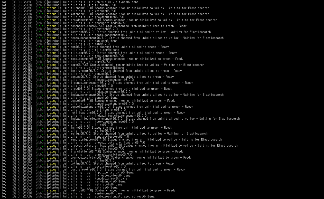

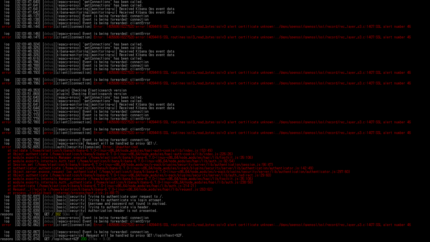

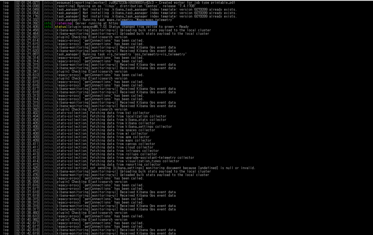

Can you set logging.verbose: true in your kibana.yml, restart Kibana, and post the complete log file?
Here is kibana log
※ The certificate was created using elasticsearch-certutil.

Are you seeing these errors logged as soon as you go to Kibana's home-page?
yes.
When i connect with a kibana url, the error immediately occurs.
Hey @Yungyoung_Ok, when you go to Kibana, are you seeing a warning about the certificate not being trusted, similar to the following:
I have created a certificate with the elasticsearch-certutil command. Should I not use this certificate in a kibana?
@Yungyoung_Ok you can definitely use the certificates created by elasticsearch-certutil in Kibana. In my testing, I'm seeing this error logged when connecting using a certificate that the browser doesn't trust, and you proceed anyway with the warnings. In this situation, that log message can be ignored, I've created https://github.com/elastic/kibana/issues/35004 to improve the logging experience in these situations.
