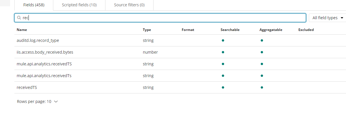

Yes, the script I created and the one which is the scripted filed documentation both are same. Now my question is why am I not able to convert the string to number or date in the Index pattern
If those fields contain numbers they should be mapped as numbers in Elasticsearch. You will need to reindex to accomplish this.
Please find the attachment as field are in numbers even then I find string in data type, what would you suggest?

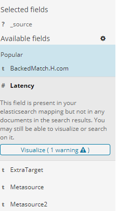

I was able to create latency filed with the script below: doc['mule.api.analytics.repliedTs'].value.getTime() -
doc['mule.api.analytics.receivedTs'].value.getTime()
However when i choose latency filed it has the warning mentioned below:
This field is present in your elasticsearch mapping but not in any documents in the search results. You may still be able to visualize or search on it.
However when i This field is present in your elasticsearch mapping but not in any documents in the search results. You may still be able to visualize or search on it.
