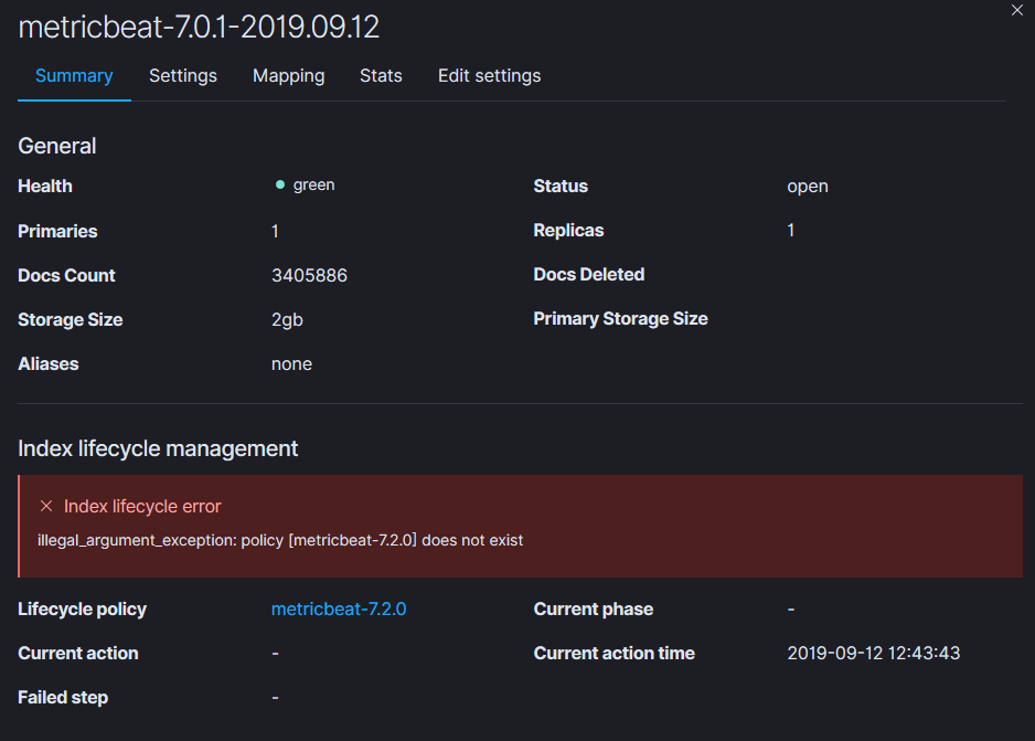

The problem now is on the new indexes on the metricbeat. Every new index on metricbeat is assigned to a different lifecycle policy of this one that i have created. For example i have created the metricbeat_policy and the new metricbeat indices were assigned to a metricbeat-7.2.0 policy like that. The difference from Metricbeat and Filebeat and Winlogbeat is that has as output the elasticsearch.

This is the
You can try deleting the metricbeat-7.2.0 policy
I have already deleted the metricbeat-7.2.0 policy.
All the new metricbeat indices that were created today have assigned to this policy
And these are my policies

The problem is that the new metricbeat indices are not going to metricbeat_policy directly.
Have you missed in this template the * symbol in the index_patterns? because that could be the reason why your new indexes are not going to metricbeat_policy
