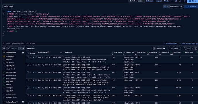

When I am speaking of ES|QL I mean from Kibana - Discover, that is where I would start
This is logs, but will work with any indexed data Timeseries or Not...
Discover ESQL Editor
I would look through this in detail
There are some detailed tutorial here (not really about extraction/text manipulation) but you can get to that next...
Then you can move on to text manipulation using any of these
Or These
GROK and DISSECT are 2 of the primary text extraction Processing Commands
Each of the function have a simple ROW example, so a simple text extraction using GROK could look like this
ROW a = "2023-01-23T12:15:00.000Z 127.0.0.1 some.email@foo.com 42"
| GROK a """%{TIMESTAMP_ISO8601:date} %{IP:ip} %{EMAILADDRESS:email} %{NUMBER:num}"""
| KEEP date, ip, email, num
Or something sophisticated like below, which processes complex log lines using GROK that are all coming in as a single field and extracts them out into all the separate fields I need to see, and then aggregates or filters them on...
And then aggregate on the fields I extracted
You could do more search / matching / concatonating / substring, whatever you like
So take a look, read a bit, follow the example and bring us some actual use cases and lets see if we can have a little fun... I assure you it is quite powerful and growing...

    dkim_alignment = CASE(
        LOCATE(rest, "adkim=") > 0,
        SUBSTRING(REPLACE(rest, ".*adkim=([^;]+).*", "$1"), 0),
        NULL
    // Extract SPF alignment mode (aspf) if present
    spf_alignment = CASE(
        LOCATE(rest, "aspf=") > 0,
        SUBSTRING(REPLACE(rest, ".*aspf=([^;]+).*", "$1"), 0),
        NULL
    // Extract percentage (pct) if present
    percentage = CASE(
        LOCATE(rest, "pct=") > 0,
        SUBSTRING(REPLACE(rest, ".*pct=([^;]+).*", "$1"), 0),
        NULL
    // Extract aggregate report URI (rua) if present
    aggregate_reports = CASE(
        LOCATE(rest, "rua=") > 0,
        SUBSTRING(REPLACE(rest, ".*rua=([^;]+).*", "$1"), 0),
        NULL
    // Extract forensic report URI (ruf) if present
    forensic_reports = CASE(
        LOCATE(rest, "ruf=") > 0,
        SUBSTRING(REPLACE(rest, ".*ruf=([^;]+).*", "$1"), 0),
        NULL
    // Extract forensic options (fo) if present
    forensic_options = CASE(
        LOCATE(rest, "fo=") > 0,
        SUBSTRING(REPLACE(rest, ".*fo=([^;]+).*", "$1"), 0),
        NULL
| DROP rest
| SORT @timestamp DESC
| KEEP @timestamp, message, dkim_alignment, spf_alignment, percentage, aggregate_reports, forensic_reports, forensic_options
| LIMIT 10
You will get something like this....
Hope this gives you some ideas!!
Lots of choices to process.
Have a great Weekend!
Thanks
