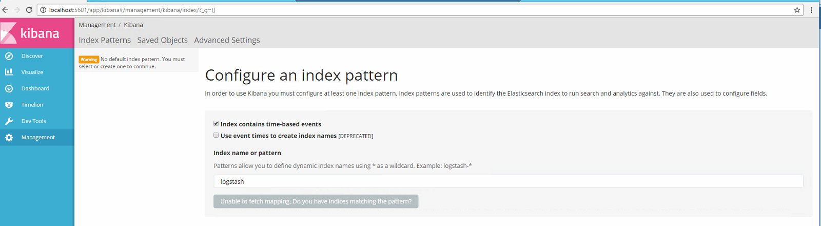

As i can see from Logstash logfile its template was instaled. Then please tell me why i still can not see this template instaled in Kibana\Elasticsearch?

Have you indexed any data into Elasticsearch? Can you provide the output from the cat indices API?

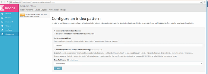

i have indexed some data and looks like time field appeared and now i can create index template.
yellow open logstash-2017.03.06 UXxhdZsqT2a_4uNZgCJIOQ 5 1 3418 0 885.9kb 885.9kb
BUT! it works only for the case of data from Azure blob where i have many log files (thousands of logs). But if to index only 1 small file locally it still doesn`t work, does not appear. Is there any limit on the data which should be indexed to make index work? And i thought that i should first create an index and only then start to index data but not vise versa. And should i have the same config on all the ELK nodes or i can use on each node different configs for different input sources for different indexes to avoid one big general comprehensive config on all the nodes which is not so easy to make work? Thanks in advance!
It seems like you're confusing indexes with index templates, which could partly explain why you're having difficulties.
No.
Indexes will automatically be created as needed based on the documents you're indexing.
Are you talking about the Logstash configuration? If yes, then it's up to you. Regardless of what you choose things will get complex but in different ways.
