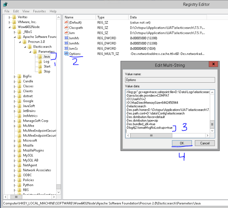

We were finally able to resolve this by making changes in registry at
HKEY_LOCAL_MACHINE\SOFTWARE\Wow6432Node\Apache Software Foundation\Procrun 2.0\Elasticsearch\Parameters\Java
Here's an Options multi-line entry where adding the setting and restarting ES windows service worked.
I couldn't find any documentation for this on ES docs. Would be helpful if someone finds it and share its link here.
