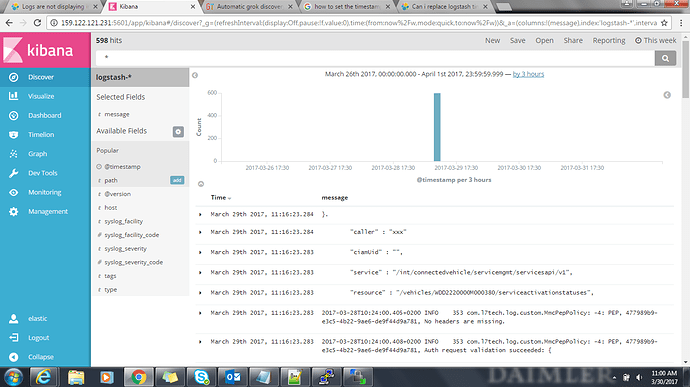

Hi Christian,
My output is looks like below in kibana.
and the output configuration is like below.

Please copy and paste the output from the stdout filter you have configured. This will show us the structure and content of your events and make it all much easier to debug.
