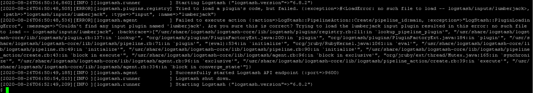

Filebeat is rightly processing the data. However when I run Logstash config file I get the below error:
Attempted to resurrect connection to a dead ES instance, but got an error.
I've checked the logstash logs and they say:
Couldn't find any input plugin named lumberjack, are you sure this correct?
I've run this same config file in a windows installation before and it'd worked seamlessly. Can anyone point out, is there a problem with the config file or what needs to be checked to troubleshoot this error??
PS: I'm using I'm not able to copy text logs, hence uploaded the console images.
Please don't post pictures of text, they are difficult to read, impossible to search and replicate (if it's code), and some people may not be even able to see them :slight_smile:
@warkolm I'm aware of the difficulty, but the stack is being used in a VM, due to which I cannot copy the logs. :frowning: But I've made sure, to attach the config file and the host info which should help in replication. Do let me know, if there's any more info you need to replicate this.
Is Elasticsearch listening on localhost on the VM?
@warkolm No it is present on an AWS Centos7 server. All of the components are installed on the same server (awselk01). I've tried changing the output to, since that was mentioned as one of the potential solutions, but to no avail :
hosts => ["http://awselk01:9200"]

Thanks. And Logstash is running on this same VM right?
Given that Logstash complains about the lumberjack plugin which is not in the config you shared, is it possible that you have other files in the config directory that would get picked up. If you have multiple files Logstash will read all and concatenate into a single pipeline. If the other file(s) had errors this could cause the pipeline to fail and no data being indexed.
Are you starting Logstash with a single file as argument or using the config directory?
Yes Filebeat, Logstash, Kibana and Elasticsearch are all running on this server (awselk01). And I was able to run filebeat and its able to communicate with Logstash on port 5044, I could see that on the logs. I've tried to run the syntax check of the conf file as well, it passes with the message 'OK'. It's just that it is not able to pass the indexes to elasticsearch on port 9200.
@Christian_Dahlqvist Yes, I think there's one more config file in that dir. I'll try to remove that from there and run it. I'll let you know how it goes.
Also make sure the Elasticsearch output uses localhost.
Yes, it is already set as localhost:9200 as you can see in the conf file I've attached at the top.
@Christian_Dahlqvist I was running the config file passed as the parameter. Nevertheless, I removed the other conf file and run it. Still getting the same error.
