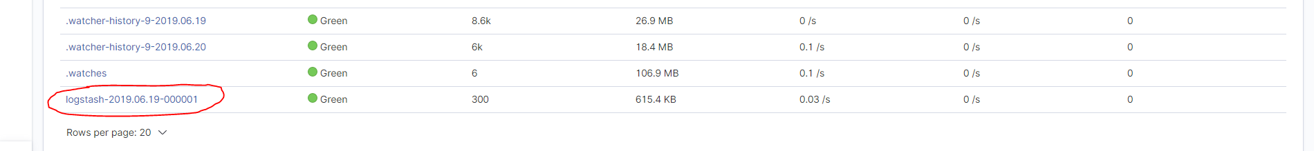

There are a few good indications that the data successfully made it to Elasticsearch. For instance, when I run the curl 'http://es-host:9200/_cat/indices?v' command...
...the index successfully appears here. Kibana also sees this index in my production cluster, which seems like good news...

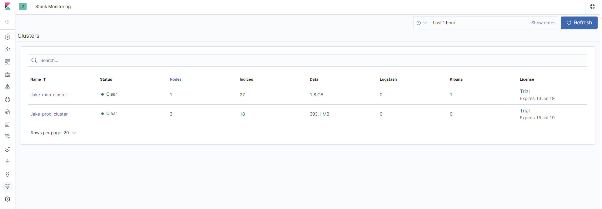

...however, Kibana does not see the instance of Logstash in my production cluster, only the index (The number under "Logstash" remains 0):
When I try to create an index pattern, the "logstash-2019.06.19-000001" index is completely missing from the list of indices I can usually choose to create an index pattern. I've let time pass for Kibana to update its UI but the problem persists. I am not accessing an Elasticsearch instance remotely. For now, Filebeat, Logstash, and Elasticsearch are running on the same machine.

There is no license check message, which suggests to me that you do not have monitoring enabled. If you run with --log.level debug what value does it print for xpack.monitoring.enabled?

OK, so you do not have monitoring enabled. What do you get for
grep xpack.monitoring.enabled /etc/logstash/logstash.yml

I had manually set the xpack.monitoring.enabled to true before running the debug. It's enabled, according to grep, but the debug while it runs says it's not.
[root@localhost logstash]# grep xpack.monitoring.enabled /etc/logstash/logstash.yml
xpack.monitoring.enabled: true
If you have updated logstash.yml and logstash is not reading it then path.setting does not have the value you expect. The debug output should show path.settings a couple of lines above the xpack values. Something like
[2019-06-24T15:39:30,742][DEBUG][logstash.runner          ] *path.settings: "/etc/logstash" (default: "/usr/share/logstash/config")
Yes, I see what you're talking about. Here is what the debug lists:
[DEBUG] 2019-06-24 11:09:18.834 [LogStash::Runner] runner - path.settings: "/usr/share/logstash/config"
In fact, this directory does not exist for me (nor has it ever).
[root@localhost logstash]# pwd
/usr/share/logstash
[root@localhost logstash]# ls
bin           Gemfile       LICENSE.txt               modules     vendor
CONTRIBUTORS  Gemfile.lock  logstash-core             NOTICE.TXT  x-pack
data          lib           logstash-core-plugin-api  tools
[root@localhost logstash]# cd config
bash: cd: config: No such file or directory
I installed this using rpm. Should I change path.settings to "/etc/logstash" as that is the directory of my logstash.yml file? If so, how can I do this?
Okay. Progress is being made. To change path.settings temporarily, I appended
--path.settings /etc/logstash to the Logstash command line. The debug output showed me this:
[2019-06-24T11:40:57,743][DEBUG][logstash.runner          ] *xpack.monitoring.enabled: true (default: false)
The default output logs now show the license check message you were referring to. I'm not sure what to do at this point.
If you are getting this message by logstash still does not show up in kibana I would start a new thread saying that and asking for suggestions. I do not run xpack, so I have no idea.
I got it!
Thanks to this thread, I found out that the commented path for xpack.monitoring.elasticsearch.hosts began with "https://", when it was supposed to be "http://" (remove the 's'). This was why Logstash was unable to retrieve my license information and failed to fetch my X-pack information from elasticsearch.
My problem was fixed by first correcting the path.settings field so Logstash would not ignore my configurations, then correcting the xpack.monitoring.elasticsearch.hosts field. Now Logstash is being monitored like I had hoped!
