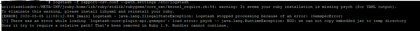

@KoettingSimon thanks for your answer, so the tmp directory has all the permissions so i don't think that's what causing the problem , and i got another problem now :frowning:
any idea ?
How many space do you have free in /tmp ? Could you share the output of df -h ? There are some other threads with this problem and it was the space problem.

yes you're right it's a space problem !! it works now :smiley:
