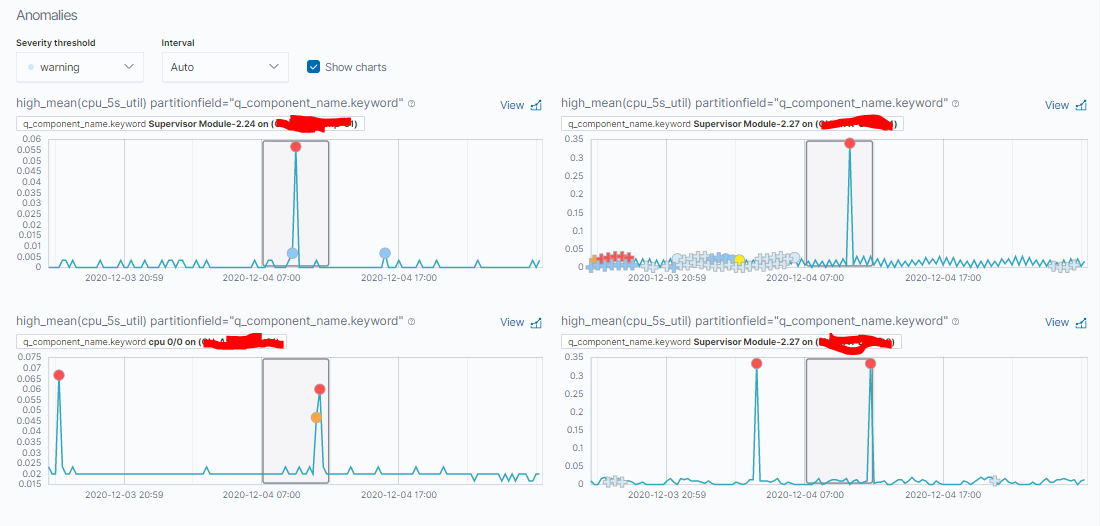

In amonaly detection I get an actual value of "75.0" when I go to a visualization of the raw data I cant find that actual value, I was thinking that maybe the agregation was blurring the value, but I choose a smaller interval in the visualization to get the raw data and still is far from the actual, the max value shown in the visualization is 35
the visualization is TSVB and is using percent format, the actual value in the watcher is multiplied by 100

values over 0.7 are from november and I got the alert with timestamp "2020-12-04T12:30:00.000Z"
another weird thing is that when I click on the link of the watcher mail to go to the anomaly explorer, it doesnt match the top records that comes in the mail

Hi Rich, Thats one of the problems the actual value is not there when I search for it on Discover, but when execute the watch I get the value 0.75 which later in the script I tranform to 75 multiplying it by 100
the watcher is set to look for anomalies in 30d, for testing...that should be a problem right?

The timestamp of 1606115700 is from November 23rd, not Dec 4th as you're showing in Discover.
Are you sure you're looking back that far in Discover? Also keep in mind that timestamp is in GMT and you may need to adjust for your timezone given that by default Kibana will show you times in your local time zone.
Thanks for your answer Rich, but I dont understand, that is the range that the query returns in the bucket result, that should be the range on where the bucket anomaly was found, or Im wrong?
All that I was saying is that you showed me a screenshot of the .ml-anomalies-* index and it showed a record from Nov 23rd. Your screenshot of Discover showed Dec 4th. These are obviously two different dates and I wanted to make sure you realized that if you were looking for this specific anomaly record that you had the wrong date.
In your latest screenshot, you're showing a bucket result (result_type:bucket) with a timestamp of 1607085000 which corresponds to Friday, December 4, 2020 12:30:00 PM GMT, but bucket results don't list actual values, only result_type:record results do.

-Yes, the only actual value, in the last 30 days, equal to 0.75 is from Nov 23
-the range on the watcher is 30 days
-yes, bucket result doesnt list actual values, only results do, but the timestamp of the bucket is what defines the time showed on the mail alert
and also set the range of time on where the bucket anomaly ocurred
this range is used on the link of the mail alert to show the anomalies on the anomalies explorer
,time:(from:'{{ctx.payload.aggregations.bucket_results.top_bucket_hits.hits.hits.0.fields.start.0}}',mode:absolute,to:'{{ctx.payload.aggregations.bucket_results.top_bucket_hits.hits.hits.0.fields.end.0}}')
If the alerted record anomaly ocurred in Nov 23, why is included in a bucket anomaly which point to December 4?
