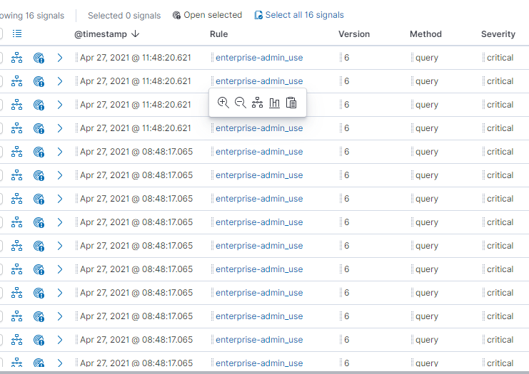

Right now , this query is looking for any event.code:Login with specific accounts as you can see ther is signals for 1 event. I am asking which Ml function would reduce this to 1 signal

But, with that said, I could imagine a scenario in which you create an ML job that used an aggregated query in which the signals index was queried, but aggregated the count on the signal names were calculated. Then ML could invoke the count function with a partition on the segregated rule names. The query being made would look roughly like this:
GET .siem-signals-*/_search
  "size": 0,
  "query": {
    "bool": {
      "filter": [
          "bool": {
            "filter": [
                "term": {
                  "signal.status": "open"
            "must_not": [
                "exists": {
                  "field": "signal.rule.building_block_type"
          "range": {
            "@timestamp": {
              "gte": "2021-02-07T00:00:00.000Z",
              "lte": "2021-02-07T01:00:00.000Z",
              "format": "strict_date_optional_time"
  "aggs": {
    "count_per_name": {
      "terms": {
        "field": "signal.rule.name",
        "size": 1000
(but of course you'd remove the range clause and follow the suggestions in the documentation about how to get an ML job's datafeed to effectively utilize a query with aggregations)
This kind of query would yield results that roughly looked like:
and it is those aggregated counts that ML could analyze (with the count function and use of the summary_count_field_name flag to track the count values over time.
