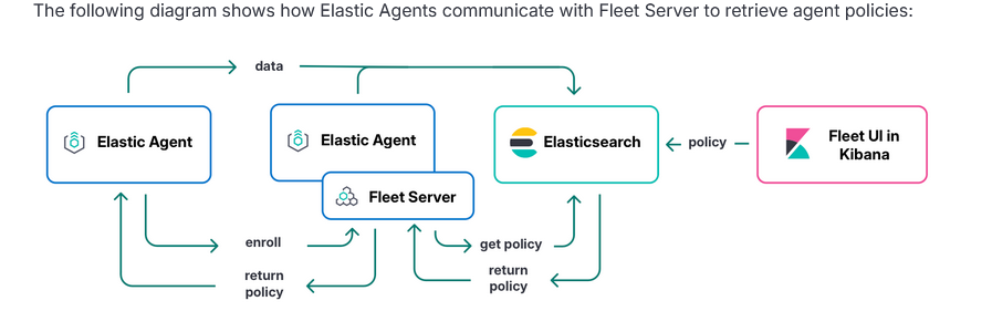

Question: In the picture above why the --certificate-authorities have two values : fleet-ca, agent-ca . Just a TYPO?!

This is a comma separated list for paths; it's specifying the CA fleet-server uses to validate connections it makes (fleet-ca) and the certificates that agents present to it agent-ca.
You can pass a single CA bundle, or paths to multiple CAs

The second picture is wrong and this is the right picture:
