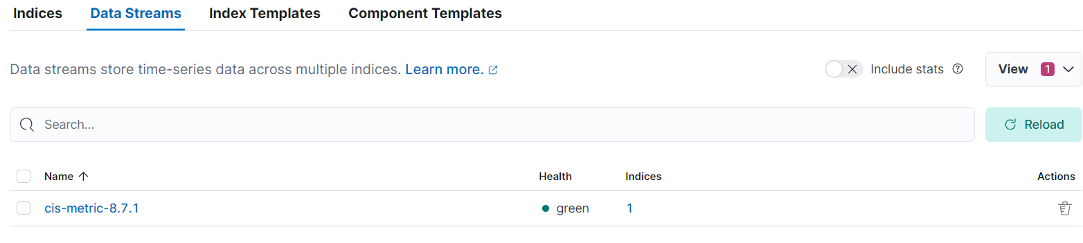

Applied the same config you provided.Below is how it looks like,but the docs in index are not coming. May I know if you are using your own custom template defined for mapping fields coming from metricbeat?
TWO TEMPLATES:
cis-metric : I've committed in devtools-has my own mappings.
cis-metric-8.7.1 creates automatically ,from metricbeat.yml
How demo templates looks like:

No I did not create a custom template metricbeat does it automatically... I think they are colliding or something...
Can you take your custom template out and try... clean up everything and try again...
then we can work backwards to your custom template.
and I can see it is not the same because the policy name is wrong
Mine is this..
setup.ilm.policy_name: cis-metric
Your shows : cis-metric-policy
Which means your template is being used... not the automatically generated template referenced with my configuration.
I suspect there is some mapping issue in your custom template vs the auto generated one...
Did you actually look at the logs or run in the foreground with the debug flags I showed you?
Hello @stephenb ,
My bad,I did mistake in metricbeat.yml, your above config works fine and now I'm getting the data in my index.
Mistake done was added this: index: "cis-metric-%{+yyyy.MM.dd}",removed and worked fine with your congigs now.Thanx for you efforts on this.

Let me know how this can be done. Plz glance my Metric beat custom template and how data from beats could be mapped to custom templates?
Ofcourse I tried everything from documentation ,with no luck of data stream getting created for custom template/policy,and not sure now to achieve this.Its work in progress for now.
CRUX: I would request to help out how to send data to respective indices following custom template and custom policy. Not using by default ones.
For now with data streams seems confusing, rollover not supported ,then where could i define rollover alias type setting.
I guess without using data streams also this could be done,but did'nt got relevant docs.

Hello @stephenb ,
Below is my custom index template and for this I tried two metricbeat.yml config and then started metricbeat.Now data stream was not created.
I hope the template you have shared was created custom and then tested?, bcz the syntax I see is of by deafult metricbeat in template and asked to add/edit additionaly1)my mappings 2)index patter anme,3)
"data_stream": {
"hidden": false,
"allow_custom_routing": false
Plz look my template and config metricbeat files.From what settings exaclty metricbeat will underastand to pick my own template,assuming below:
1st case:
setup.template.enabled: true
setup.template.name: "cis-metric-%{[agent.version]}"
setup.template.pattern: "cis-metric-%{[agent.version]}"
2nd case:(here ilm is not defined in what you have shared,then how it will understand which ILM)
setup.ilm.enabled: false
setup.template.enabled: false
I have changed in yml and in template the policy name to: cis-metric-policy as per my req.
Note: I'm building an ELK automation solution where in No user will ever come to Kibana page,
admins just vist custom webui integrated dashbords.
So what I do is,intially only create my cis-metric-policy with my settings in devtools/kibana policy page and then assumes when metricbeat will start with yml that also contains this policy name then it will automatically map to already created ILM policy.Intention to do so: No user will visit kibana page only webui.
PUT _index_template/cis-metric-8.7.1
        "index_patterns": [
          "cis-metric-8.7.1"
        "template": {
          "settings": {
            "index": {
              "lifecycle": {
                "name": "cis-metric-policy"
              "mapping": {
                "total_fields": {
                  "limit": "10000"
              "number_of_shards": "1"
          "mappings": {

metricbeat.yml config 1:
metricbeat.config.modules:
  path: ${path.config}/modules.d/*.yml
  reload.enabled: false
setup.ilm.enabled: true
setup.ilm.check_exists: true
setup.ilm.policy_name: cis-metric-policy
setup.template.overwrite: false
setup.kibana:
  host: https://abc:5601
output.elasticsearch:
  hosts: ["https://abc:443"]
  index: "cis-metric-%{[agent.version]}"
  ssl.certificate_authorities: ["/l/ppp/config/ece_proxy_root_ca.pem"]
  protocol: "https"
  username: ""
  password: ""
processors:
- rename:
    fields:
    - from: agent.hostname
      to: host.name
    ignore_missing: true
    fail_on_error: false
- drop_fields:
    fields:
    - host.mac
    - ecs
    - agent.ephemeral_id
    - agent.type
    - agent.version
    - agent.hostname
    - event
Above congig didn't work then tried this:
setup.kibana:
  protocol: "https"
  username: ""
  password: ""
processors:
- rename:
    fields:
      to: host.name
- drop_fields:
    fields:
    - host.mac
    - ecs
    - agent.type
    - agent.version
    - agent.hostname
    - event
Both ways data stream was not created.
Hi @PRASHANT_MEHTA
I get your requirement....I think you're missing my point. :slight_smile:
If you run setup the way I showed you, it gives you all the correct assets... Best Practice assets (ILM, policy, template, data stream etc) it was just a way of getting a set of best practice assets.
Afterward, you just edit them to meet your requirements.
Then can you just capture those with a GET command (fix the opening and closing {}) fix mappings to what you want then POST and create the assets as part of your automation before you run metricbeat.
I think the confusion is that since you are creating all the assets MANUALLY you do not need to run setup and the datastream is created when you run metricbeat at runtime. not during setup ... which does not need to be run
Here is my complete code process using YOUR template (I changed the version number only)
First Clean Up and Post all the Assets ILM Policy and template
DELETE _data_stream/cis-metric-8.8.0
GET _ilm/policy/cis-metric-policy
DELETE _ilm/policy/cis-metric-policy

Then this is my metricbeat config... all that is needed for the template, IILM and output section (I am not looking at all your other config.
  hosts: ["https://localhost:9200"]
  username: "elastic"
  password: "password"
  ssl.verification_mode: "none"
AND I think this is your confusion since you set everything up Manually you do NOT need to run setup command the datastream is created at first run / run time
Then simply run
metricbeat -e
Or however, you want to run and the Data Stream is created at run time using the assets you previously installed.
That is all I did and I used your template
GET _data_stream/cis-metric-8.8.0
  "data_streams": [
      "name": "cis-metric-8.8.0",
      "timestamp_field": {
        "name": "@timestamp"
      "indices": [
          "index_name": ".ds-cis-metric-8.8.0-2023.07.10-000001",
          "index_uuid": "dUKP92isQX2DUHbM4CaX7A"
      "generation": 1,
      "status": "YELLOW",
      "template": "cis-metric-8.8.0",
      "ilm_policy": "cis-metric-policy",
      "hidden": false,
      "system": false,
      "allow_custom_routing": false,
      "replicated": false
@stephenb ,
Thanx again for your time to look into this. I will do whatever you recommended above and may test in few hours.Thanx for your patience :sweat_smile:,Migration is hectic.
Only confusion: Where the datastream will understand which policy to follow for cis-metric-8.7.1,as in below config ilm policy info is not there,even what I do PUT ILM policy and template itself first in devtools then run metricbeat.I'm thinking how the data stream will get to know which policy to follow with below:
  username: "elastic"
If you understood me right,what I do:
1)First commit template and ILM in devtools
2)run metricbrat.yml
3)Expect that data stream will now map with my template only and follow my ILM only(commited earlier in dev tools)
How metric beat is run by me:
start.sh
#!/bin/ksh
echo "Starting metricbeat..."
./metricbeat &
_pid=$!
echo "$_pid" > metricbeat.pid
echo "Pid $_pid stored in metricbeat.pid"
It is defined in the template that is all that is needed...
Yes if you put the ILM policy and the template in FIRST before running metricbeat then it should work.
PUT _index_template/cis-metric-8.8.0
  "index_patterns": [
    "cis-metric-8.8.0"
  "template": {
    "settings": {
      "index": {
        "lifecycle": {
          "name": "cis-metric-policy" <!---- Right Here
BTW all the manual setup (i.e. no running setup ) is actually a very common approach for customized deployments.
Hello @stephenb ,
Many thanx for your time on this.Everytime I wondered same index template and ILM I provided you and things work fine with you and not my end.
Now issue is resolved but please be informed how its working now and not previously.
How issue got solved:
As you mentioned you are using 8.8.0 ,here this is valid(cis-metric-%{[agent.version]}),same is not valid in 8.7.1 and I need to manually put index name only and now it works,weird:
8.8.0:
index: "cis-metric-%{[agent.version]}"(yml)
I'm using 8.7.1 version and I need to do below,this is not good practice,any alterantive or what might be the reason in 8.7.1 this cis-metric-%{[agent.version]} dont work:
8.7.1 using below then only data stream created.
index: "cis-metric-8.7.1"(yml)
Alternatively do u think it would be fine if i remove 8.7.1 from-index pattern,template and from yml and instead only use cis-metric only.
I hope similar is the approach for all beats i.e heartbeat and filebeat(custom template and ilm),like how did for metricbeat for data streams?
