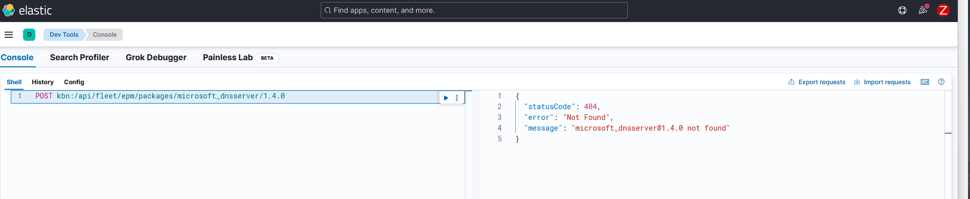

In Kibana Dev Tools
POST kbn:/api/fleet/epm/packages/microsoft_dnsserver/1.4.0
Security Onion people says that is because they still use 8.17.3. And they think that v1.4.0 is available only from Elastic 8.19… Can this be a reason?
DevTools said “not found”.

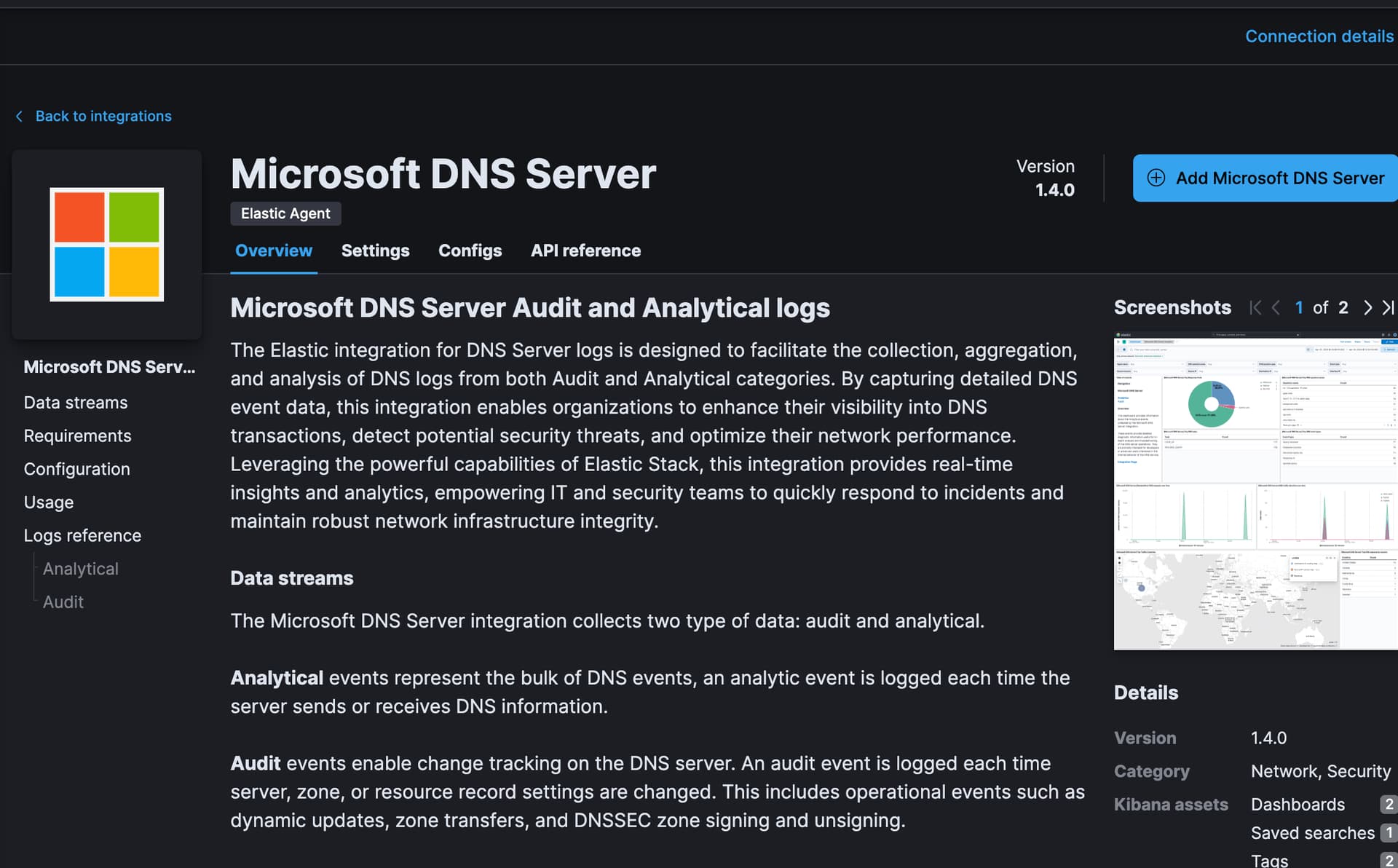

Settings page:
This is a fresh Elastic Cloud 8.17.3 and Support Integration 1.4
Readme says :
The minimum kibana.version required is 8.13.0 .
I suspect your issue has something to do with the Integration Repository EPR I suspect not updating..
