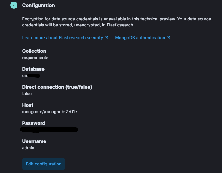

Here is the MongoDB configuration in Index setup
I have no problem connecting to MongoDB and reading from this database/collection using the same credentials from another client such as Robo3T or mongoshell.
