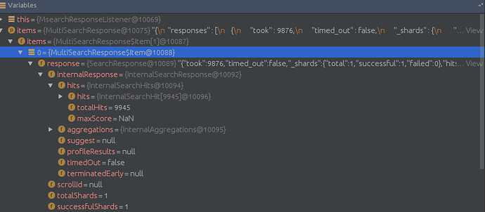

I have a total of 10000 docs in my index A. I am trying to access response hits in my custom plugin class to modify my output for a use case.
When I am using the below for loop statement, response hits are only 9945.
My expected hits should be 10000.
for(MultiSearchResponse.Item response : items)
Attaching a
screenshot of response.
Please help.

Here is the original image you posted:
The totalHits is 9945, not 10000.
I don't understand why you think there is an issue.
It's showing as 9945 but the total hits when I run through curl which I posted earlier
gives totalhits as 10000
In the below code :
SearchHit[] searchHits = response.getResponse().getHits().getHits();
if(searchHits.length > 0){
for(SearchHit hit : searchHits){
Map<String, Object> sourceMap = hit.sourceAsMap();
I am left with 9945 hits instead of 10000 hits.

At the moment you initially run the request, you had 9945 hits that matches your query. That's all what I can say.
There is no bug here.
As I said, I believe that you did not refresh the index before running your first search.
But if you think there is an issue, please share the full code which can help to reproduce the problem.
